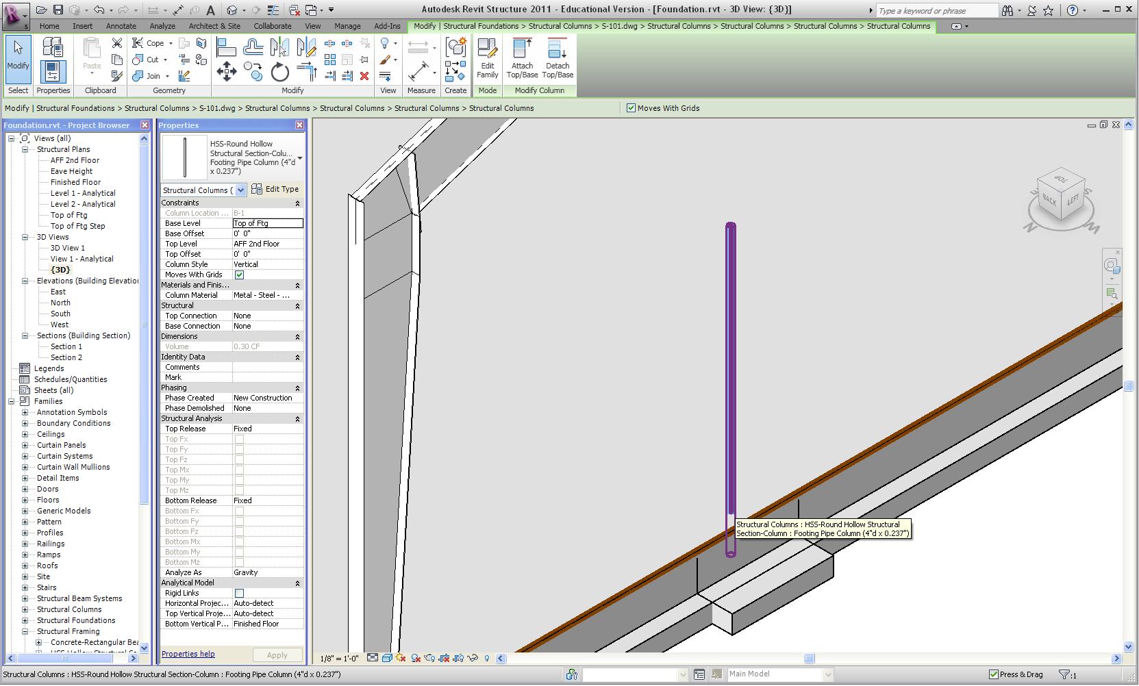

I am having trouble attaching a column I have to the Finished Floor. When I do it automatically brings up the footing below. I modeled most of the turn-down slab edges myself and also had to sketch the slab, as the PEMB acts at the main load bearing force in my model and a "Pick Walls" option was not possible.
Just curious as to how I can detach the base of the column and bring it to the FF.When I try to establish placement before setting the column it gives me an error message that "Top Constraint is invalid for the Level". This is only necessary on 4 of the columns I have.

I was able to adjust it by modeling the footing in place and then put the column down, which seems to be working Just worried how this could affect the analytical model.
