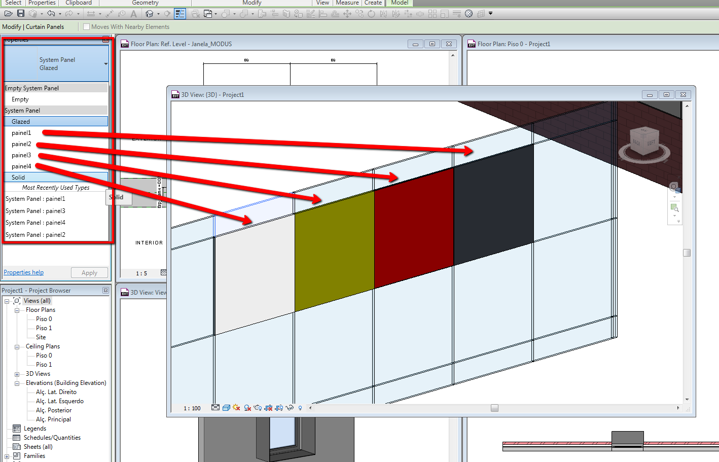

I would like to change the material of a curtain by pattern system I created using a mass, when I access the instance properties I only get 3 options: clear, glazed or solid. I would like to place a translucent white plastic material, but I can’t find a way, I’ve also tried with the painting option but it doesn’t work either. How could I do it?Thanks

Select the Panel (use the TAB key if you need), go to properties, duplicate (give another name), change what you need like material and thickness.

Same thing,  the is only 3 options available

Same answer.

I got it now, thanks a lot! :D oh and excuse my english, is not my native tongue.
