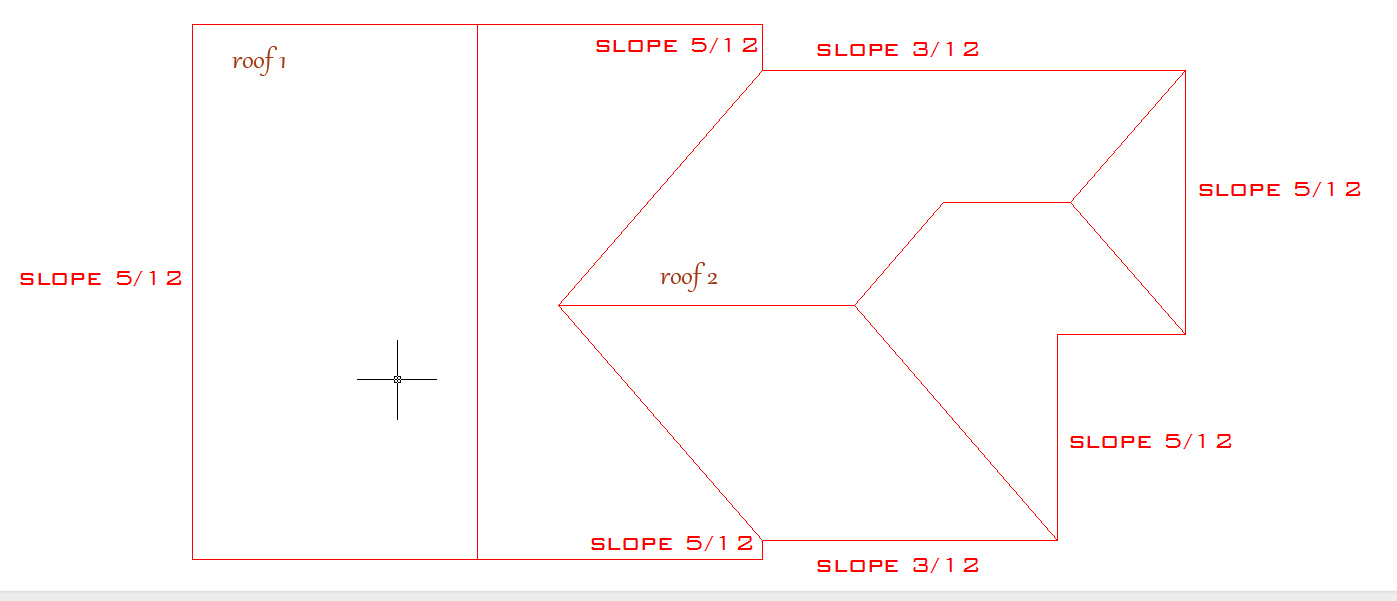

Hello,
Can someone please show me how to build this roof? I have two pieces of roofs: Roof 1 has a 5/12 slope and roof two has 3/12 and 5/12 slope. I was trying to build this roof by footprint. I wanted to build two pieces separately and then join them together, however  I don't know how to build the second roof?
Your help is highly appreciated. Thanks!
Sun, Aug 29, 2010 at 7:03:38 PM | How to build a roof with different slopes?
Build this as one roof.  Just add the slope definitions to each roof edge ept the two gable ends.

THANKS SO MUCH WWHub.
It worked!
 I really appreciate it. You saved my day.
