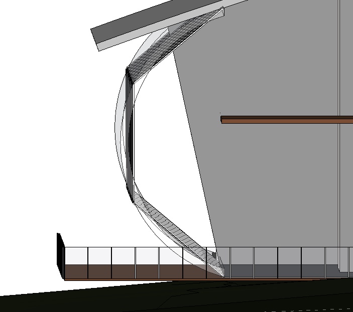

Hey guys, just wondering if any body could help me out with curving a curtain wall from top to bottom - i have tried creating a mass and then changing the face to a curtain wall but it would let me create it. I Can create the profile as a wall and then extrude it but not as a curtain wall.Here is an image of what im similarly after.It is the front curtain wall of the image.

Typhoon, the only problem with this is that when i create the curtain system from selecting the face of a mass, it creates a curtain wall that is essentially 3 different angles rather than an arc?
