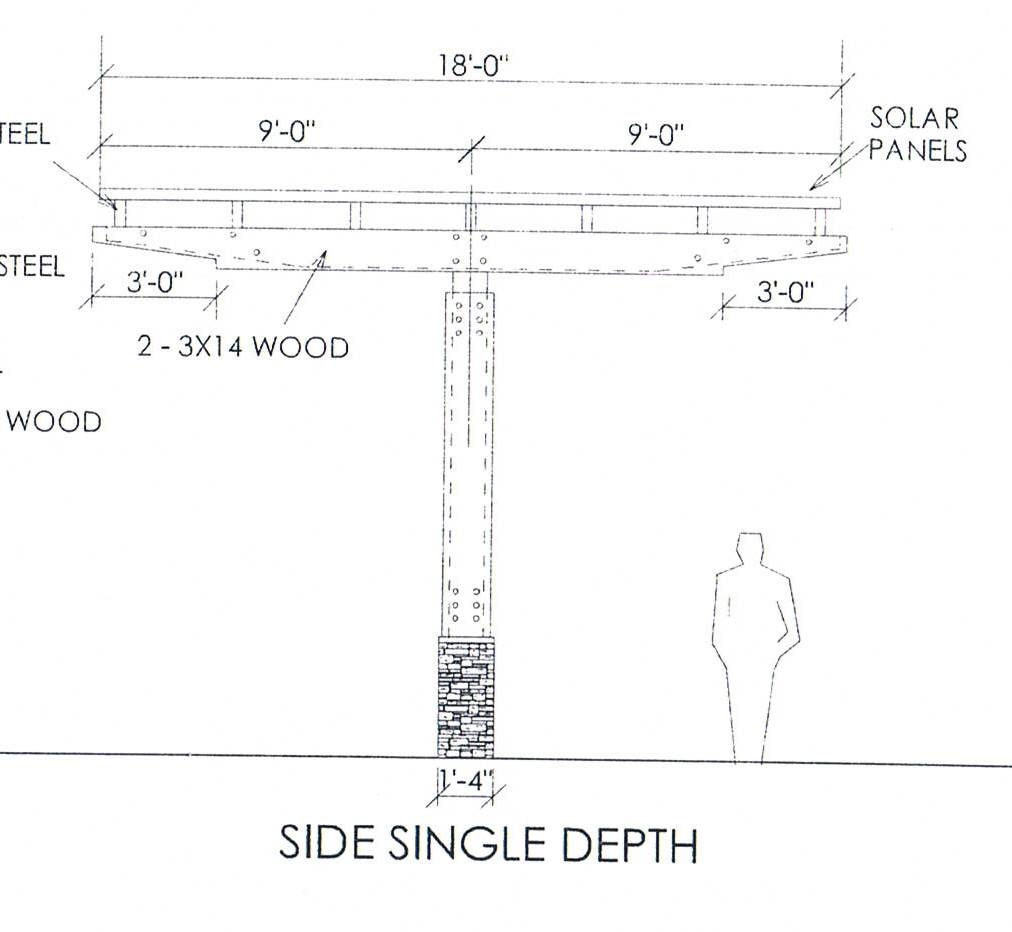

I am working in a  carport job now and my client wants to have an angled joist at the ends and I've tried to edit a joist family without any luck.
Since I find a picture easier to explain my problem and ultimate goal, please, see attached the general idea and a detail of what I need my rendering to looks like.
Thank you

Did you ever get an answer?
Duplicate the joist typ and rename it.
Edit the family
add a void locking the void to the proper dimensions.
Might be a better way, but this worked for me.
