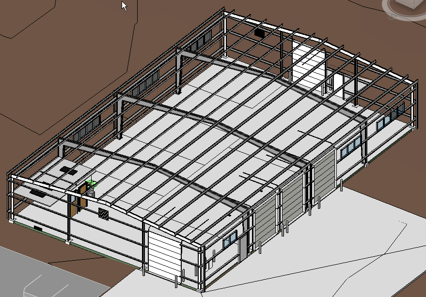

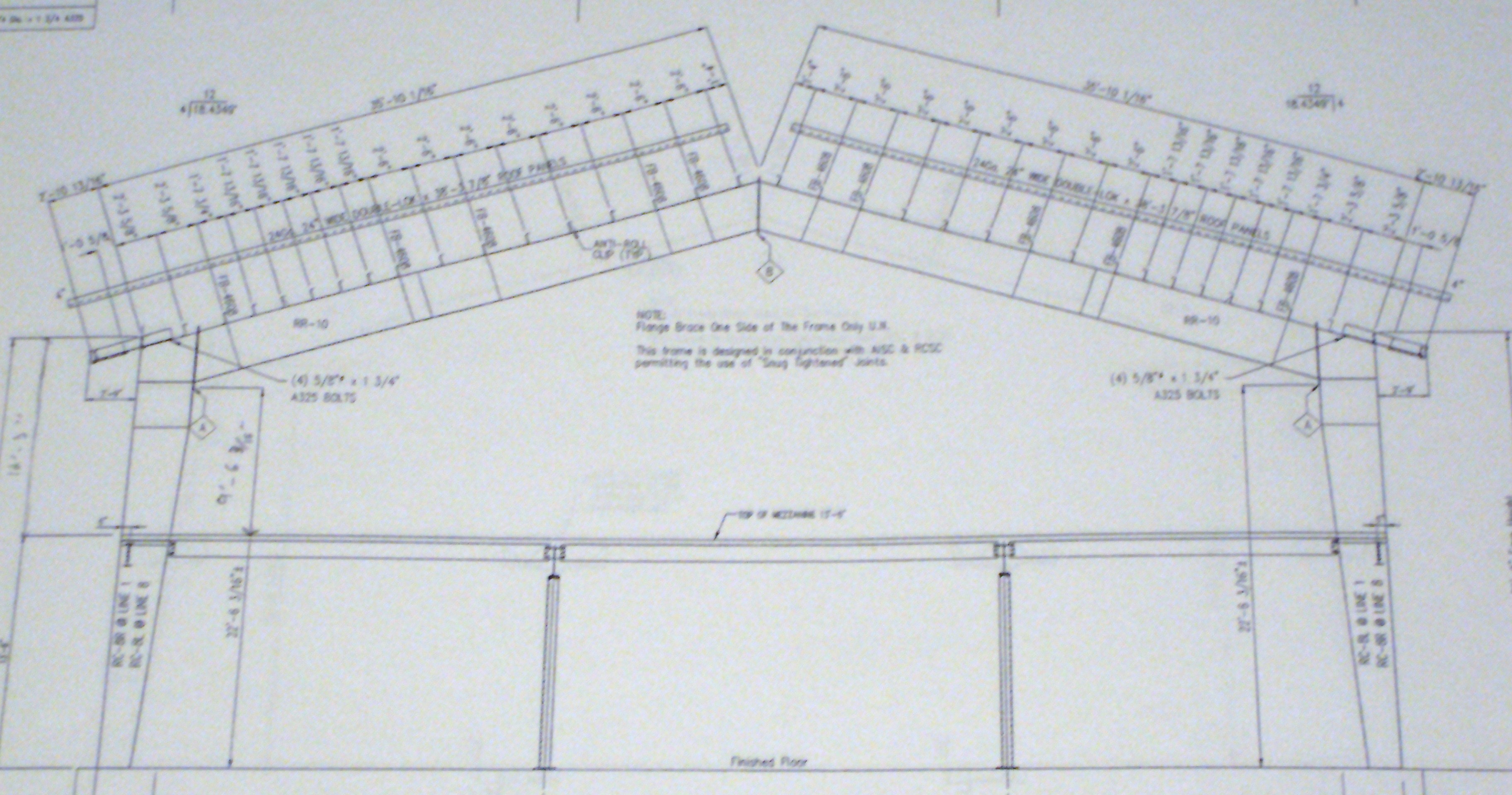

Hello! I am a current student that is new to Revit Structural and curious as to the best method to create a Pre-Engineered Metal Building. It has tapered columns and and tapered rafters that vary along 8 grid lines.
I've attached an image of the basic outline of it to give you a better idea of what I am working with. The rafters are not tapered in this picture, but vary in the next few pages, along with the columns. I am curious to know if it would be easier to edit a family type of columns, then rafters and attach them on the floor plan? Or would it be simpler to create one large Pre-Engineered Metal Building unit for each grid line?
Any help would be greatly appreciated, thanks!

You can do all of this in Revit - see attached.  The frames I used here were adapted from the frame family that is in the download area.  Please look there.  There are several pre-engineered families there.

You can make this ridgid frame from an elevation view and make it exactly like the original and then copy it. I would use the model in place as you are not likely to be reusing this frame. Just create three or four extrusions and you will be done.

The rafter ends up tapered on other grid lines. I'm just curious as to the best method of shaping this; should I use a swept blend? Which view is easiest to shape it?
I greatly appreciate all the help you guys are giving by the way. I'm slowly learning how this is all thrown together.

Swept blend would work but most of these are built up just like the actual frame.  Flanges can be sweeps along a path and the web is an extrusion from the elevation view.
