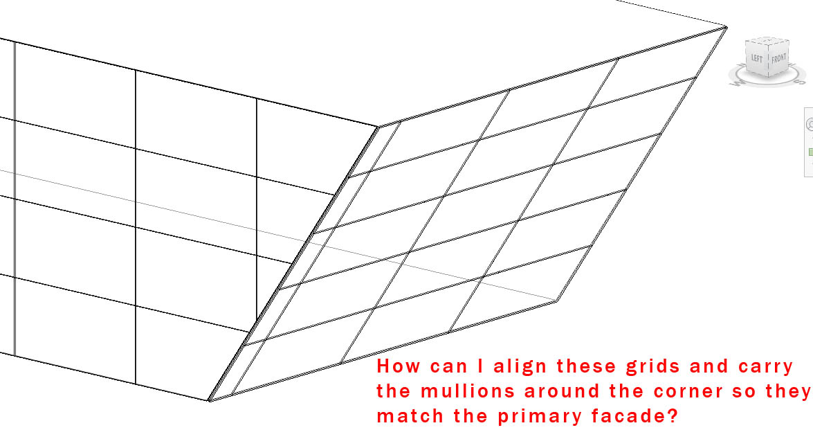

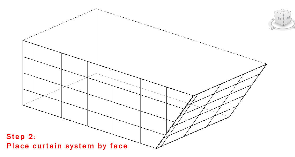

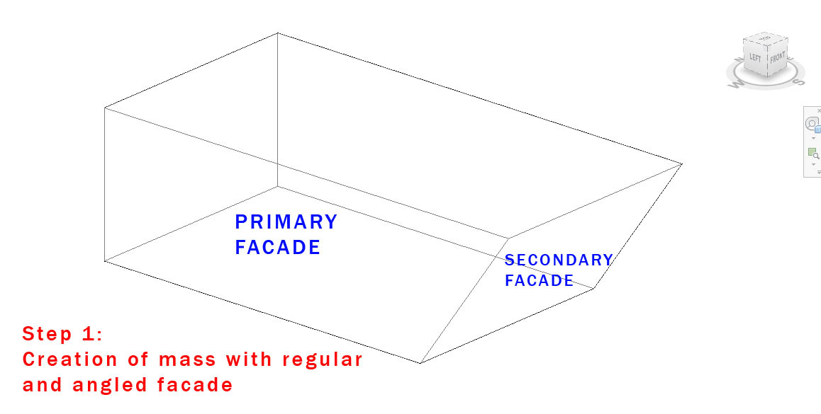

I posted this a little earlier on the forum, but got no response, so I figured I would try one last time before conceding defeat! What I'm attempting to do is seemingly simple but I can't seem to get it right. I am trying to get two curtain wall grids to align around a corner, when one of the mass faces is at an angle. The attached images explain precisely what I'm trying to do. Any suggestions would help. Thanks !

To align your grids somewhat, use reference planes and align the grids on each face to those planes.  You do realize that the standard horizontal mullions will never truly align because the mullions will remain perpendicular to the glass face.  If that is not what you want, you will have to do in place sweeps for the horizontal mullions.  You will probably also have to use a special in-place mullion that you create for the corners.

Thanks for the advice, I appreciate the quick response. That's what I was worried about. I was hoping there was a more precise way to do it, but maybe not. As far as the mullions being perpendicular, I worked through this by setting their profile to have an angle opposite of the wall itself; i.e. if the wall is angled at a 30 degrees, the mullion profile is set to have a -30 degree angle. However this still seems clunky, and is far from the accurate result I am hoping for.
