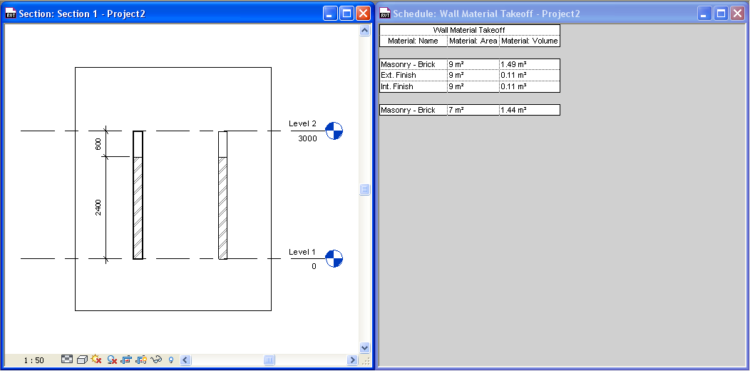

I agree Revit is not an estimating or take-off program but we can generate as much as we can if we do perfectly. Here in India most of the construction is with cocrete columns, beams and floors. Even in Architectural drawings we show almost all the Structural stuff like columns in Plans and Floors and Beams in Sections where all the 3 should get flushed which can be achieved only with Join Geometry.
When a Window or Door is placed in a wall, the wall volume gets deducted automatically. Why not when we place a Structural Column or Beam which goes into the wall? It defenitely helps us a lot instead of using Join Geometry everytime.

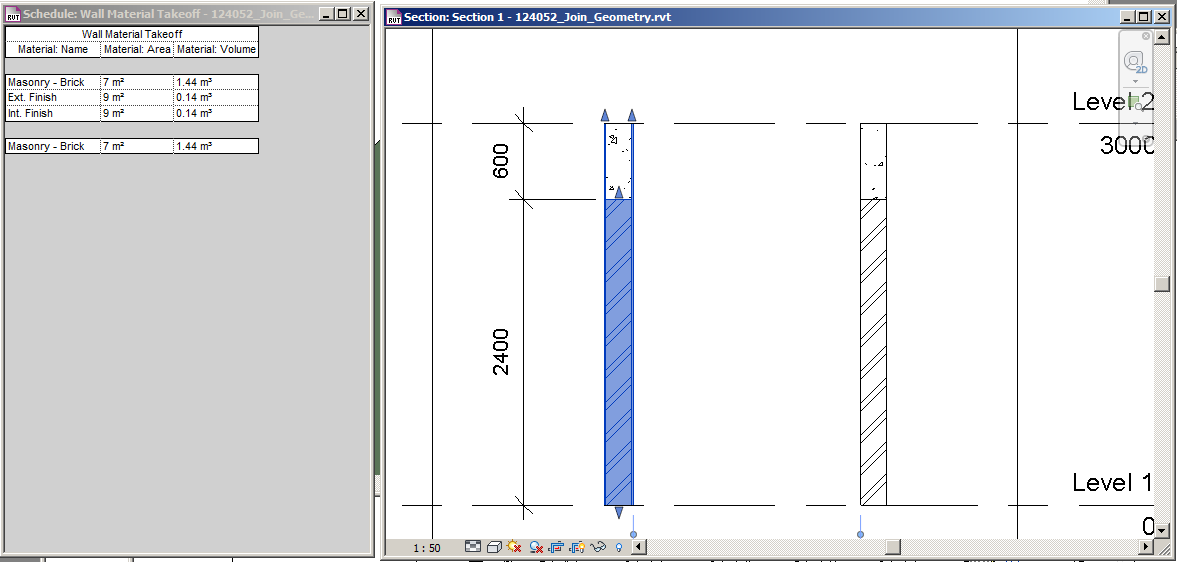

Coming to my question after I used Join Geometry for my wall and beam, I am getting correct values for the wall without finishes and wrong values for my wall with finishes. I placed Beam in the wall and joined, One wall volume is 1.487 and other is 1.44. You can check the Wall Material Takeoff Schedule and check the values by unjoining the beam and joining again. Does anyone know the reason? Please let me know if I am missing something else? Attached is a screen shot and revit model.

Fri, Sep 27, 2013 at 8:13:12 AM | Join geometry is a PAIN !!
Doors and windows are hosted by the wall and their families include a void that cuts the host.  Structural beams and colums are not hosted and don't include voids to cut a host.  Join geometry is the only means to accomplish what you want.   Not a bug but it is something you could add to a wishlist.   However, it would really bog down the program.

Thanks for the reply WWHub. You responded to the 1st half of my question. The actual question lies in the 2nd half.
Please have a look at the above post and reply. The wall with only brick joined with the beam gives correct volume and the same wall with the finishes gives different volume. Please let me know the reasons.
Find attached image and revit file in the above post. Thank you.

Fri, Sep 27, 2013 at 10:43:36 AM | Join geometry is a PAIN !!
#10
I modified your file to make this work correctly but I can't share it with you since you are in one of the earlier versions.
Obviously Revit only cuts the material graphically so I edited the wall type and unlocked the core layer.  Maybe you should consider something like that?

4.5 Stars: 3 Votes
Thanks for the quick reply. That's a nice work around, but why it is behaving like that. I can't modify all the core walls like this to get the exact values. There may be more than 100's of walls depends on the project. Can I expect this problem overcome in future versions. If it clears most of the quantities can be taken from Revit itself.
