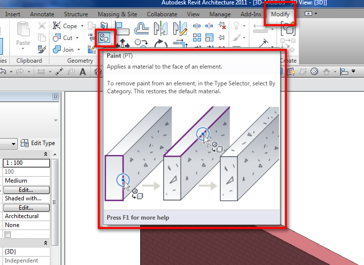

I'm trying to create a 4' high wall with a tile finish.  I've got it so there is tile on both sides but how do I have the tile wrap around the top of the wall?

Use the "Paint" tool with the material you want.

Thanks for the quick reply.  That works visually but if I take a section of the wall it doesn't show the tile actually being there.  Any ideas?

If you cut a section, add 2D linework to create what you need or use the edit cut profile to modify the tile face to extend over the wall.  This is a view specific tool - not model.

Not exactly ideal, but it will work.  Thanks for the suggestion, I was completely stuck.

use floor if you want to show the thickness, or if you are really sick like me you could create an extrusion of tile with rounded edges etc.
