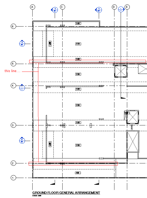

Hi,
I'm drawing a suspended slab of varying thickness with band beams.  I've used 'concrete beams (girders)' for the band beams and the slab changes thickness on the centreline of the beams.  The problem is in plan a line shows up where the slab changes thickness even though I've joined the geometry in section (and it looks ok in section).
 Can anyone suggest either a better way of varying the thickness of the slab or a way of hiding the junction of the two different slab thicknesses ?
 Thanks
Andrew

I don't have Revit here right now but in that plan view in VG expand "Slab" then you have a parameter (i don't remember the name) where you can turn off (invisible) those lines automatically instead using the linework tool..
