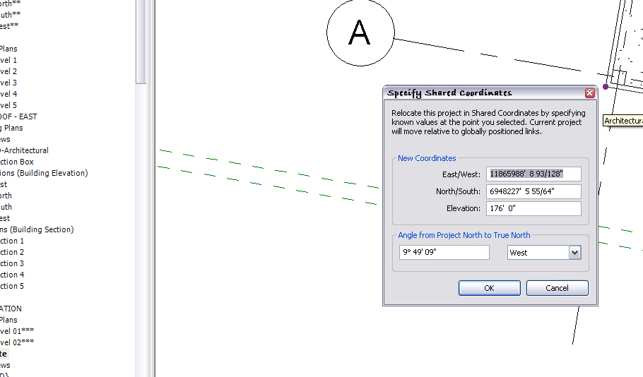

Hi,  I have a revit model I want to match up with an existing site plan in real world coordintates.  Even with the 20 mile radius update in 2011 I cannot inset the cadd plan by origin to origin so instead I have tried to center to center.  I tried manually changing the revit model to match the cadd plan by using specify coordinates at a point.  Even thouh the points read correctly in revit when I export by either project or shared coordinates they do not match.  Does anyone have an idea fro a fix in the or are people just S.O.L. if their project happens to be far enough from the origin and they want to match up civil and architectural?

If you want to match the coordinate system from CAD to your Revit model, you will want to learn about shared coordinates and get comfortable with the idea and concept.
As for the process of aligning the two files, it is really quite simple and the one part I really would emphasize here would be to use a base file and not the actual civil file.
By this I mean start a blank CAD drawing...clean of everything. Xref the site file into the blank file at 0,0,0.
Then, link that base file into Revit...I typically use center to center.
This will not only get you around the 20 mile limit, but will help avoid passing any coordinate changes back to the civil file.
Revit will actually reference the coordinates from the xref so you should be fine.
The attached images show the reported coordinates from one of our projects and as you can see...the E/W coordinates are about 2,247 miles and the N/S are about 1,315 miles...well beyond the Revit restriction.
But one more time...get comfortable with shared coordinates.

Thanks guys,
I did fix it with shared coordinates.
I had to insert the survey file center to center, specify a coordinate within revit and then let that file drive the rest (all my other revit links).
Seems to work well.
