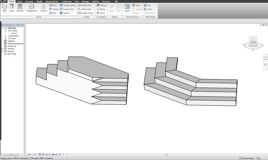

Can anyone help me with a stair question.
I'm not sure why revit creates the stairs in the attached drawing the way it does. I want to create a monolithic stair that wraps around a corner, but I'm not getting what I'm looking for.
Is there a way to get the stairs shown on the right by building only one set of stairs. When I try I get the stairs shown on the left.
Am I doing something wrong?

I can't check your model right now but i believe the issue is the same like this one: http://www.revitcity.com/forums.php?action=viewthread&thread_id=20312

It seems like it is the same issue, however neither of the links supplied in that thread are available, so I cannot see the answer you suggest.
Please note that these are monolithic stairs, not sure if that makes a difference.

"It seems like it is the same issue, however neither of the links supplied in that thread are available, so I cannot see the answer you suggest.Please note that these are monolithic stairs, not sure if that makes a difference." - Yes, we are talking about "Monolithic stairs", in that thread download the video from MEGAUPLOAD, you have there the link in my first post....

I understand that the problem seems to be that revit calculates the underside of the stair as going straight from one sloped boundary to the other, and that interferes with the top of the stairs.
Can someone please explain the steps to work around this or else post a video in a different location.
Thank you very much.

You are right, the link goes directly to "Screencast" page and not to Megaupload, now I corrected the issue BUT if you Copy/paste that same link into another page it works fine....
http://www.megaupload.com/?d=5SI8K6ZO

Thanks very much.
Working now.
