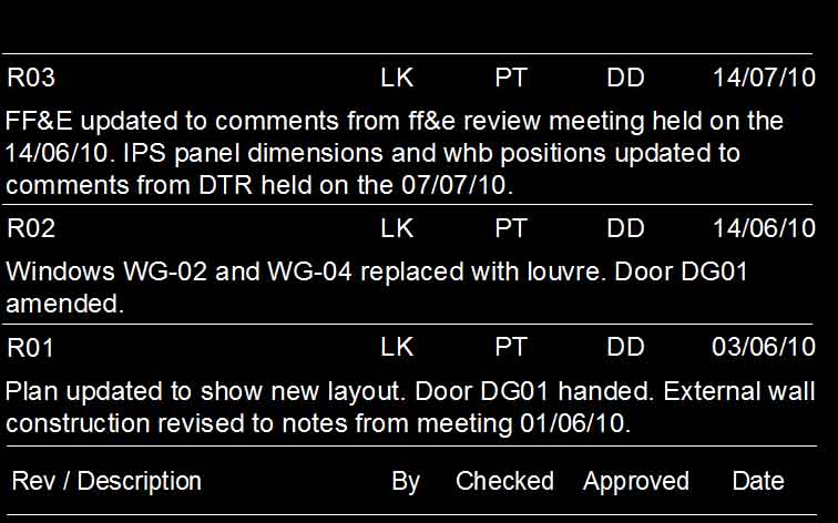

I'm trying (and failing) to set up our standard revision schedule in Revit.
We have a row at the top showing the initials of who did the changed, checked and approved and then a row below for the text.
Also, can I have a line only at the top?
See attached picture.
Can this be achieved in Revit?
The problem I have is that if I have to fit it into one row the initials take up too much space leaving the text is one long narrow column.
Mon, Aug 9, 2010 at 7:19:07 AM | Revision schedules
Sorry but at this time, schedules in Revit are limited to one row per record but the data in any column can span multiple rows.

Sorry - I don't understand what you mean by "data in any column can span multiple rows" - can you please explain...
Mon, Aug 9, 2010 at 8:42:27 AM | Revision schedules
See attached...
Mon, Aug 9, 2010 at 2:36:45 PM | Revision schedules
archie456
Joined: Mon, May 17, 2010
181 Posts
3 Stars: 1 Votes
I see.
It actually does that at the moment.
Thanks for your help anyway!
