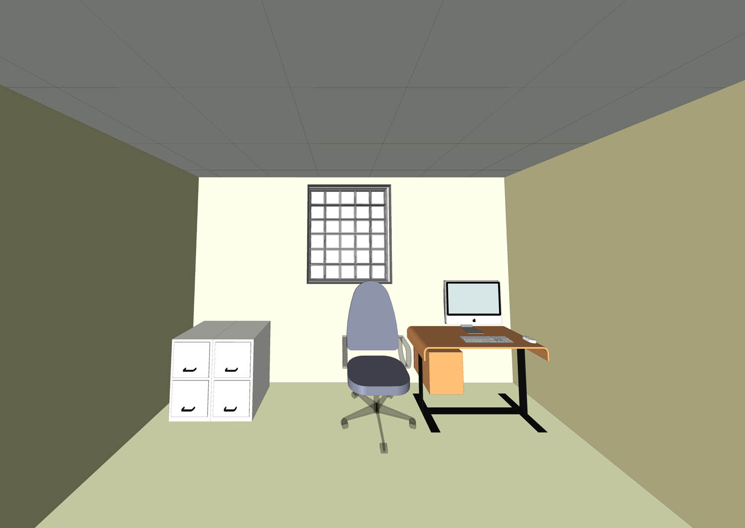

I have tried playing with the following, camera position, target location, far clip, eye location, and camera
location. I used Revit 2008 for rendering so I hoped things would get better in Revit 2010.
The attached is the best I can acheive. I can not put chairs too far from the back wall.
The chairs get distorted.  Thanks for your help anyone. Have a nice day

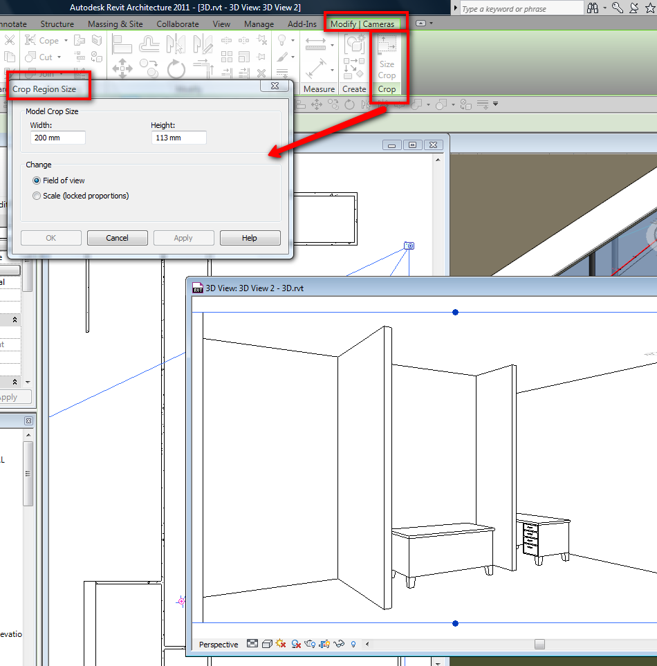

Try changing the "Crop Region Size before the other parameters.
