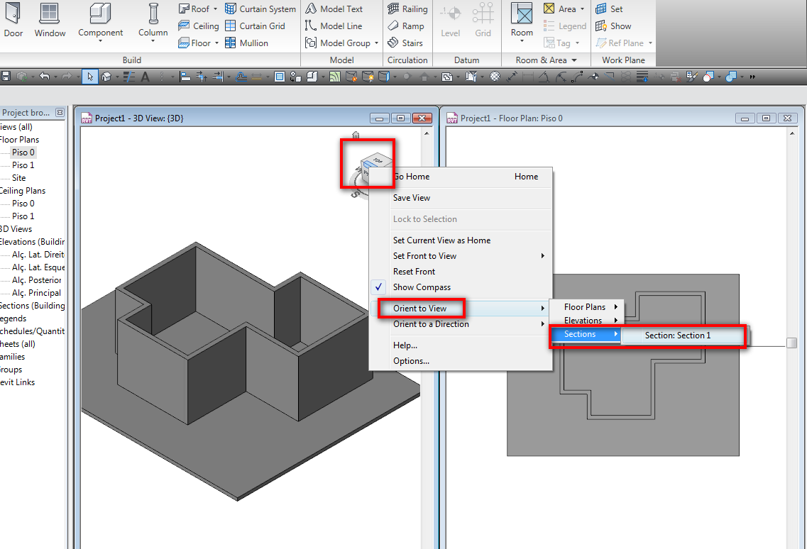

"I am able to get a section view, but obviously I can not render this or can I?" - YES you can, in a 3D view just go to the "View Cube", right click "Orient to a view > Sections and select the section you want to Render.
