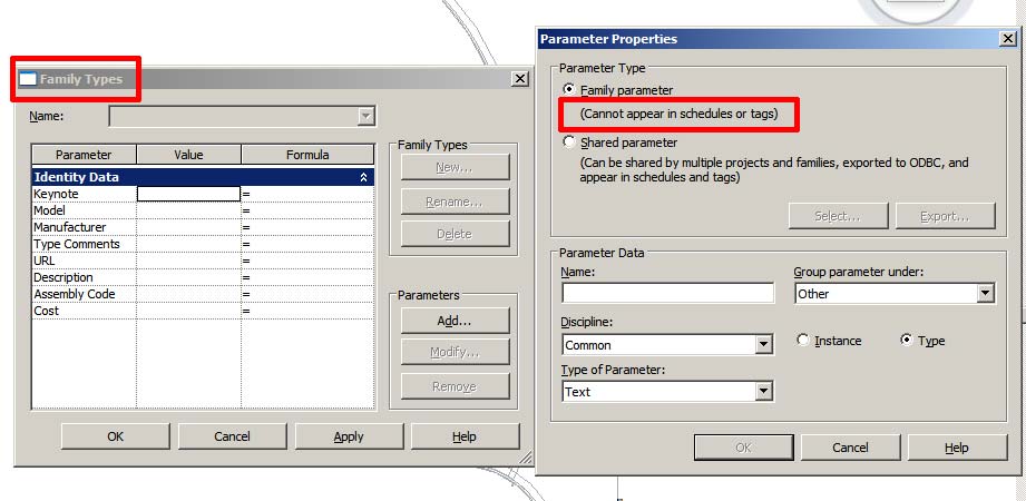

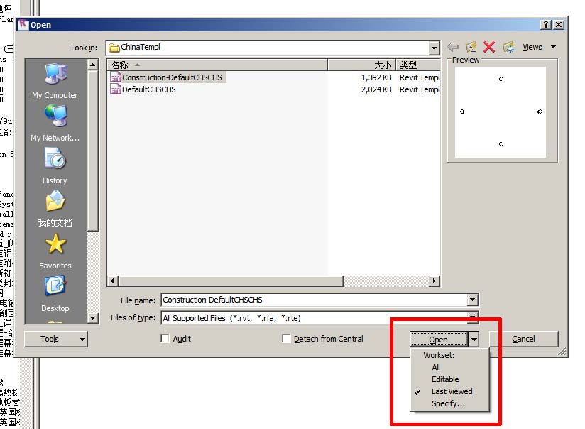

Some one told me that pick up unbased on plan when openning a template, then "Work Plane-based" and "Always vertical" under FAMILY TYPE-Family Parameters, and I could create family with slope and something else.
If my understanding is wrong, please help me show the correct steps. Thank you Thank you!!
