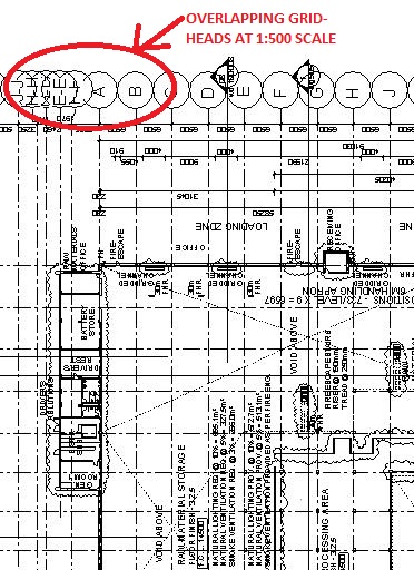

I'm on Revit 2011, and my current project is a factory which has a very large floor-plan, and I thus have 1:500 floor-plans and elevations, which I've copied a few times (as dependants), and enlarged each dependant plan to 1:100 scale to reflect a certain portions of the building.

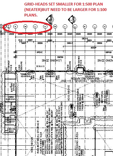

My problem is the grid-heads. For the 1:500 plan, I've set the grid-heads (circles) at a smaller diameter (since they'd overlap each other at that scale - not neat!), and I use a larger set of grid-bubbles on the 1:100 floor-plans and elevations (more legible).
Setting the gridheads seems to be project-specific, and not view-specific; ie. when printing, I have to set the grid-heads to the smaller size to print the 1:500 plans, then reset them to a larger size before printing the 1:100 plans. A bit of a schlep...
Does anyone know if one can set the grid-heads to be view-specific (have a certain size for each individual view)?

To my knowledge this is not natively supported.
This appears to be quite a common question and I think the software could benefit from this capability.
Of course as with most limitations there are various ways to workaround the problem to obtain the graphical look you desire. Unfortunately any workaround will also present its own limitations and may or may not be more work than your current method of swapping the symbol prior to printing.
Option 1
Keep your default grid head for your most prevelant plans and turn off the grid bubbles in the ones you wish to alter, create and place "dummy" grid bubbles (aligned and locked) in the necessary views. Group and repeat as necessary. Note that all new grids, or grid deletions will need to be manually coordinated.
Option 2
Create a grid export view, turn off all native grids within the views you wish to alter, export to .dwg, then link as necessary.
Note this requires a new export upon making grid changes.

Step 1 : Open the Grid Head family and delete the circle.
Step 2 : Create 2 circles of different sizes in a new 'Generic Annotation' family with 2 different names say G1 and G2. G1 with 1/4" circle and G2 with 1/8" circle.
Step 3 : Load this Generic Annotation family into Grid Head family and place at the center.
Step 4 : Load this Grid head family into your project.
Step 5 : With the V/G settings in Generic Annotations under Annotation Category tab you can control G1 and G2.
Hope this solves your problem.

Mr.thetabest, i didn't undestand why you are repeating the same solution and more over it is not clear. You may create a subcategory(for Generic Annotations) in the Grid family but can not move the lines into it. You have to create in 'Generic Annotation' Family only and load into the Grid family.

Actually, you CAN create the subcategories for grid head, but once I played with it, for some reason there is no option in visibility graphics overrides, and thus it falls apart...
