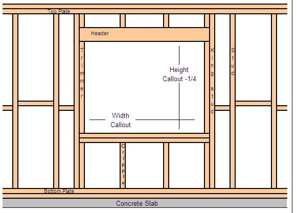

Further to what WW says. R.O. is the framed opeing that allows a door or window to fit and then be 'shimmed' into the R.O. See image.
