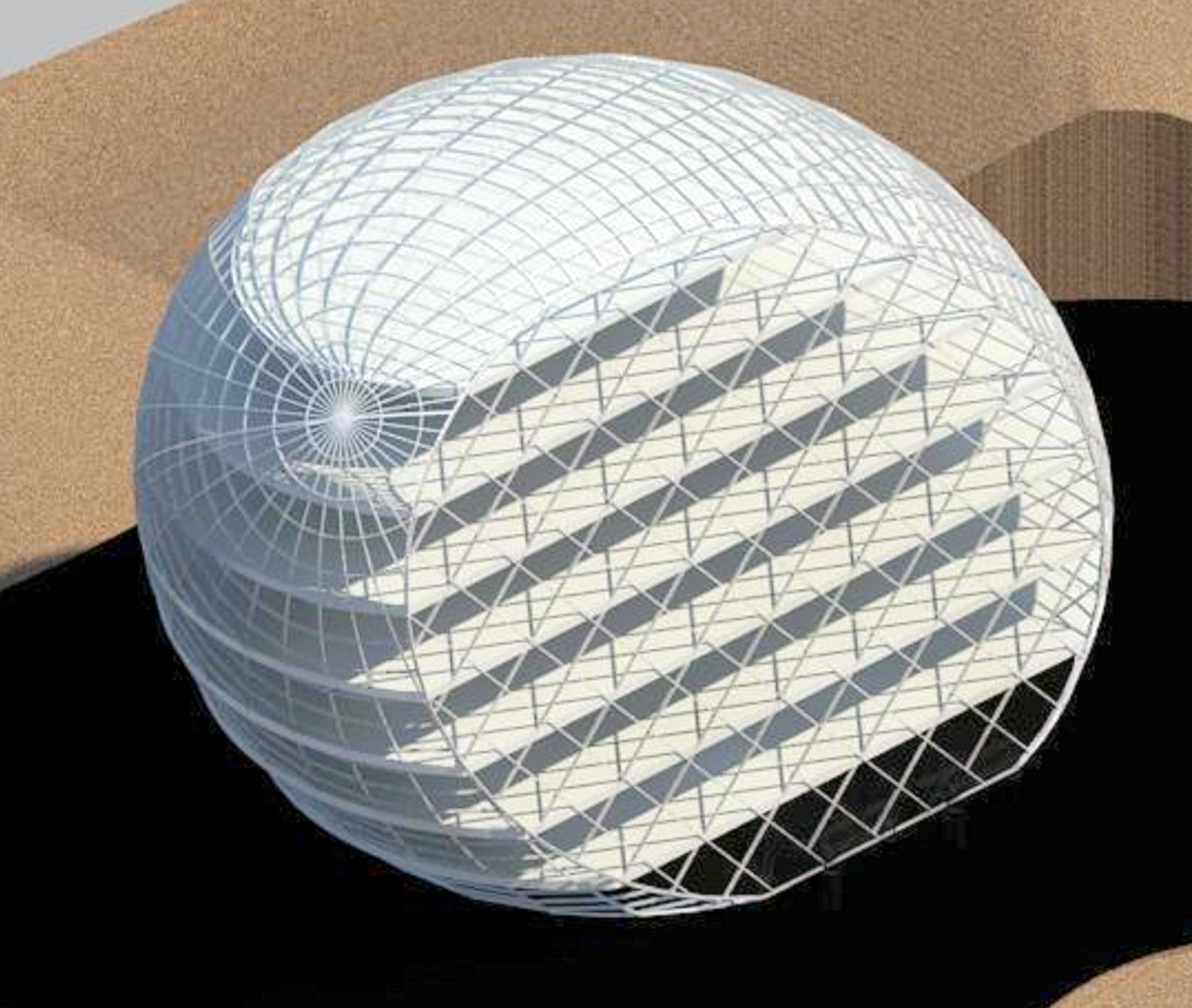

m using revit 2009...so conceptual massing is nt in it..!!
bt i made the basic structure..!! hav add it...temme how is it..!!!it has just bare essential things in it..!!even de material r nt edited
 i jus did it all by myself...so i m proud,...!!
yaaaayyiieeeee..!!!
p.s. it jus took me less den hlf hr(including rendering time) to do dis..!!! Smile :-)

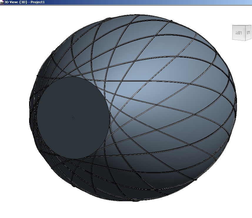

Looks good!  I gave in to temptation, and tried modeling it a bit.  I gave myself 20 minutes at lunch... I got it wrong, but the principle is sound. the rules for placement of the mullions is still a bit of a mindbender.

I think its made like this:
Line begins and ends on the same place (at start and end) and on its way it will make full spin over the mass ...
