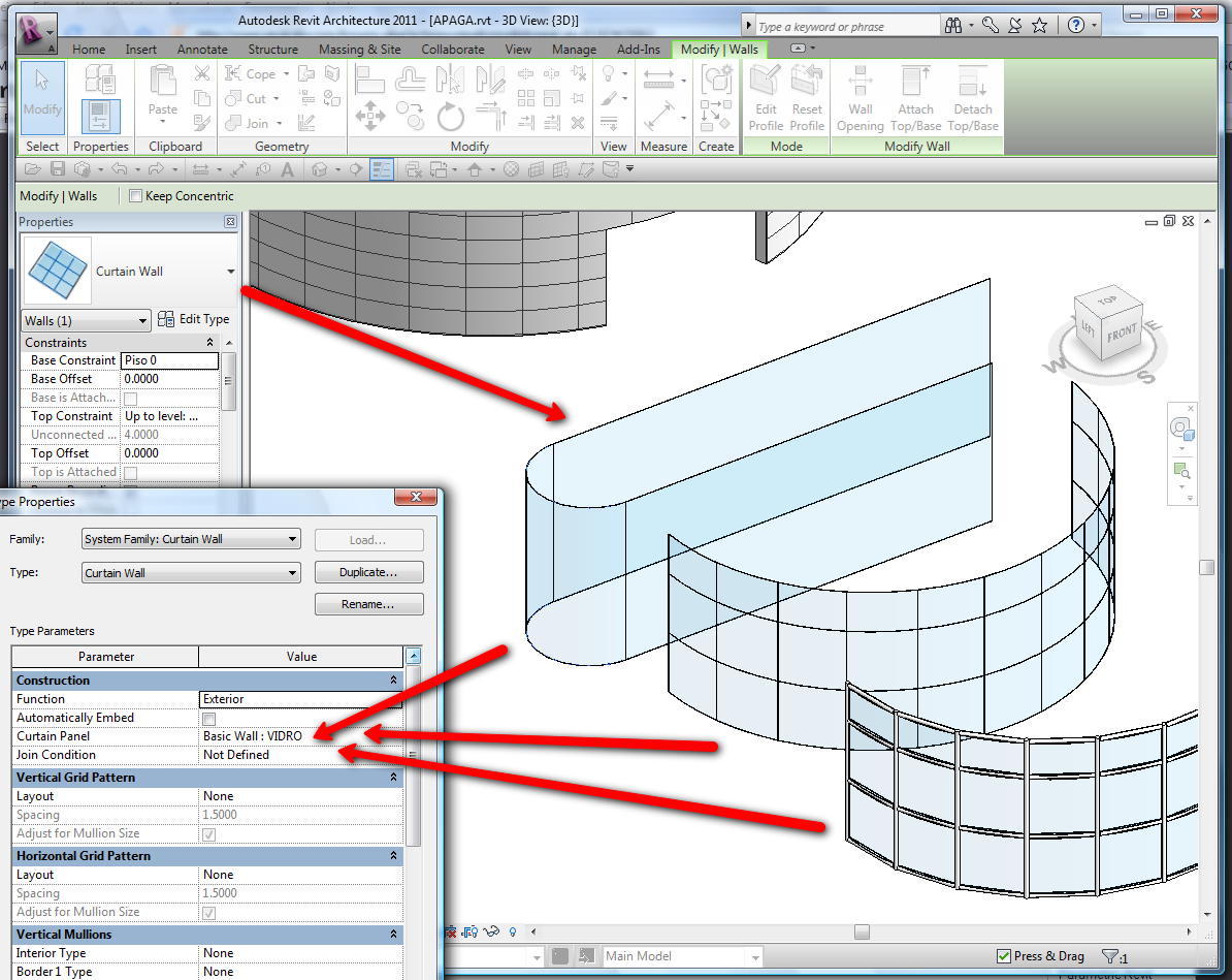

hi how can i create curved curtain wall with curved mullions or create curved surface with curved glass &curved patterns

Just create a Wall with the thickness and the material "Glass" then duplicate a new curtain wall and use that wall in the "PANEL" like you can see in the image then you can apply the grid lines like you want BUT the Mullions you need to create that in a family "In-Place" because Revit can't do that in Curve.
