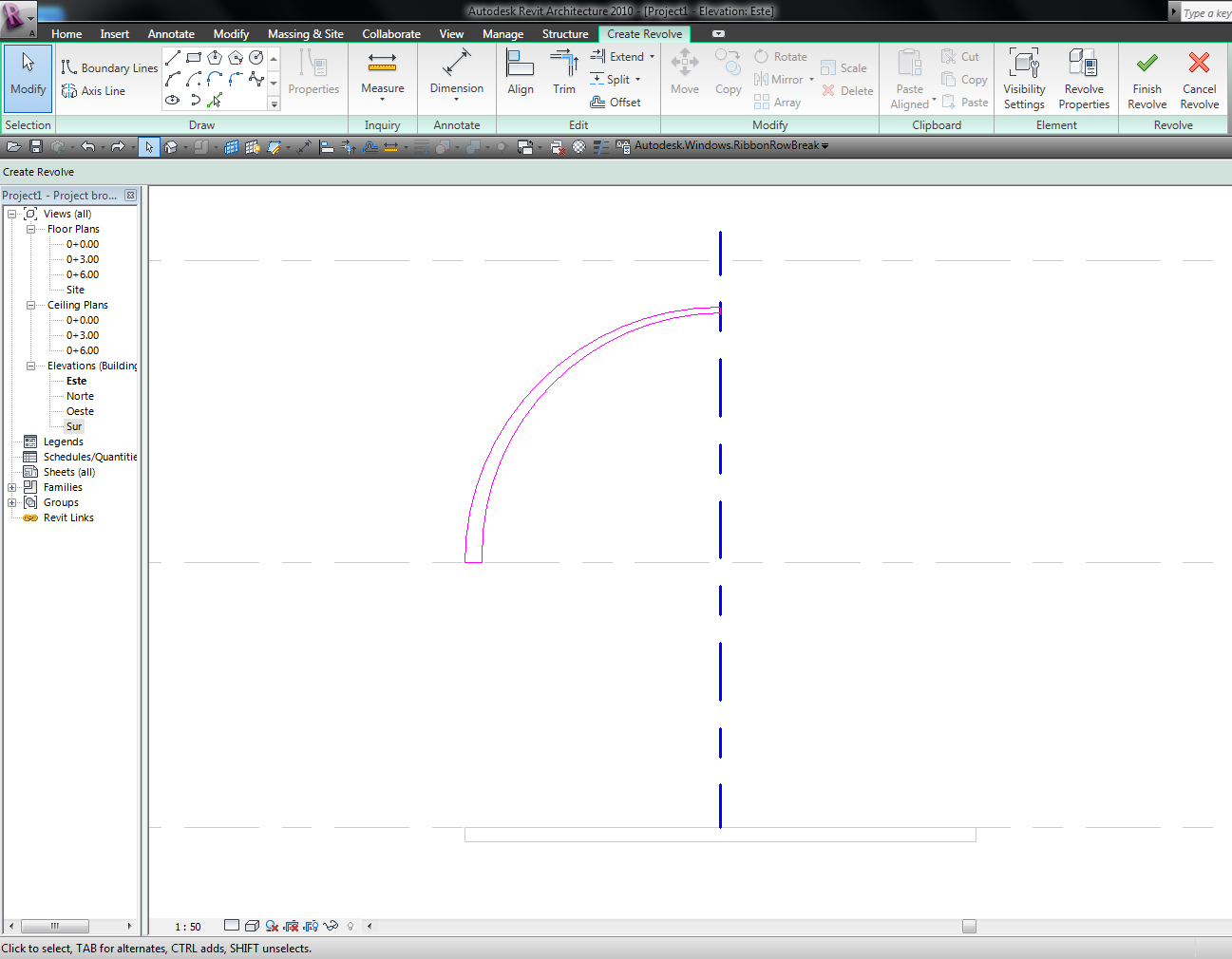

Create it with a Model-In-Place, Solid - Revolve.......

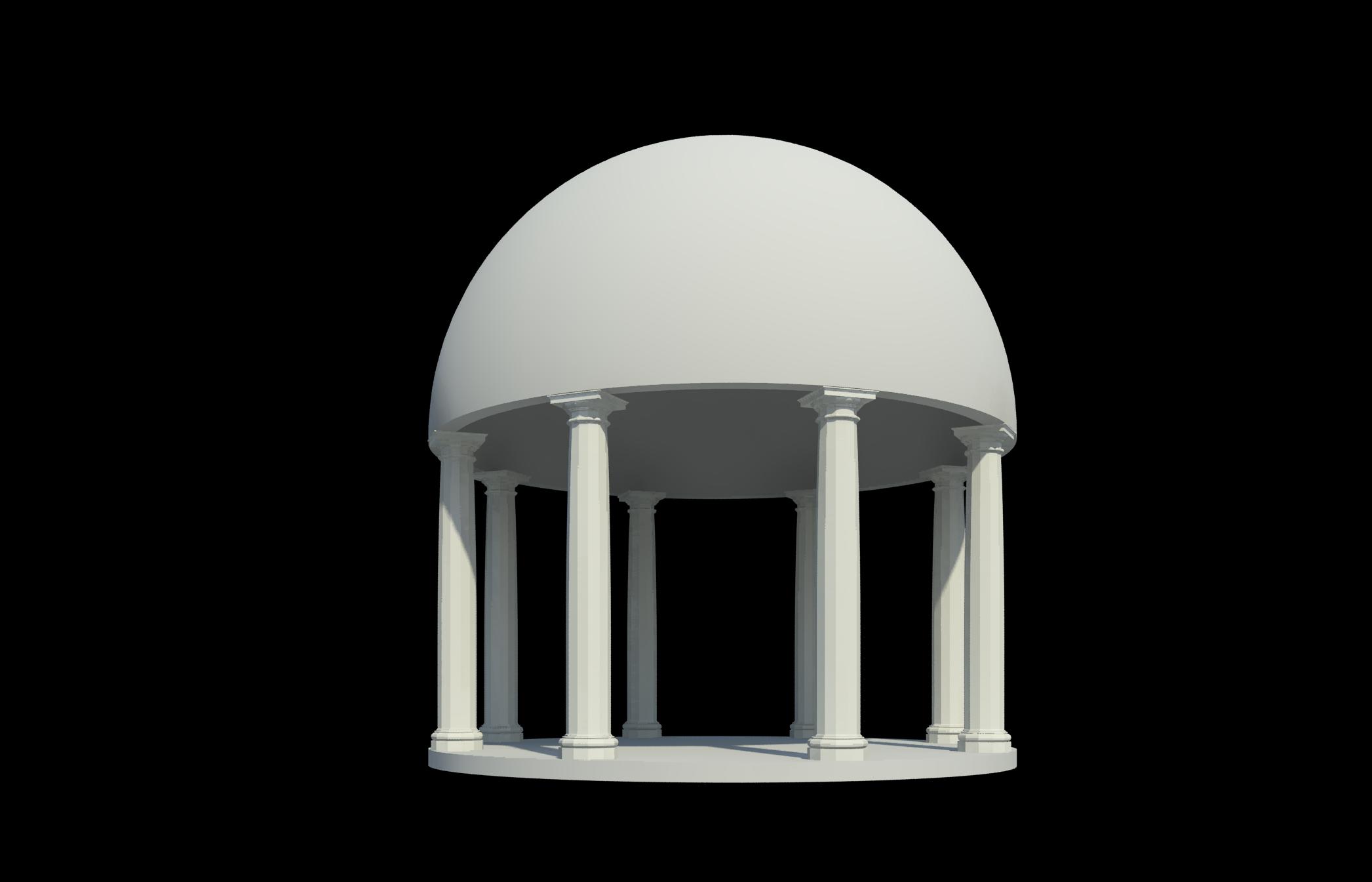

For that you need to use the "Conceptual Mass", look this link: http://www.youtube.com/user/zachkron#p/u/14/BpD-AlG-opI
Watch the video: "PimpMyDome3" that video show you what you want...
Create a half dome
