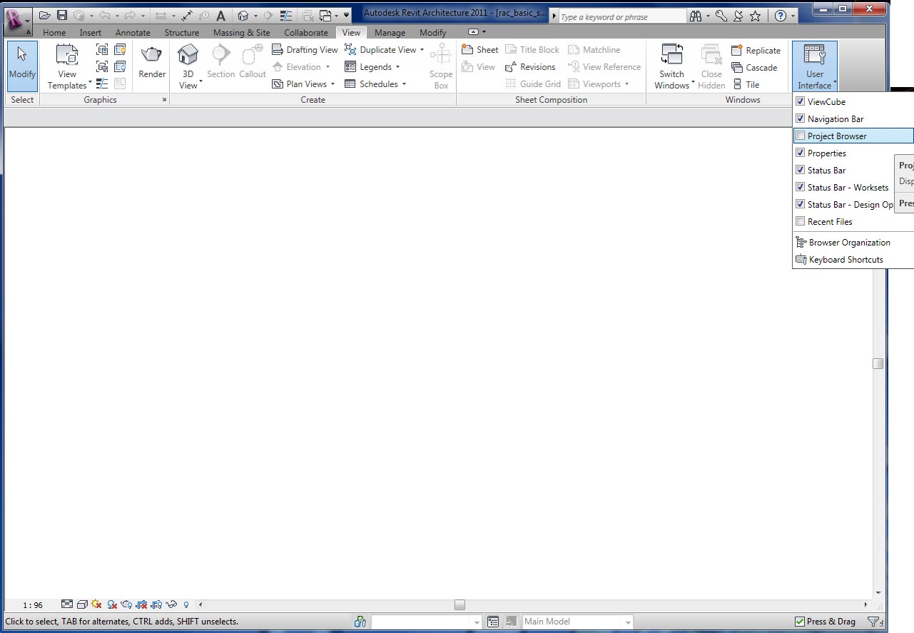

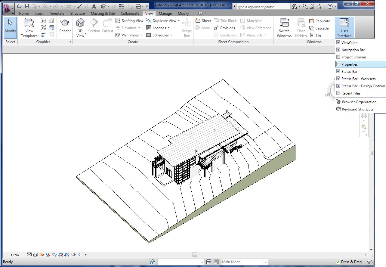

Now I have another problem, if I activate the Project Browser and the Properties Toolbars, from the >View>User Interface menu, a blank screen appears, the only way of seeing the project is by unchecking the Project Browser and the Properties boxes. (See images)
I tried by erasing the files you recomended, but it didn't work. Uninstalled the software and re-installing, and nothing.
What would be the way of doing a "clean" uninstall?
Help please, and thanks again!
