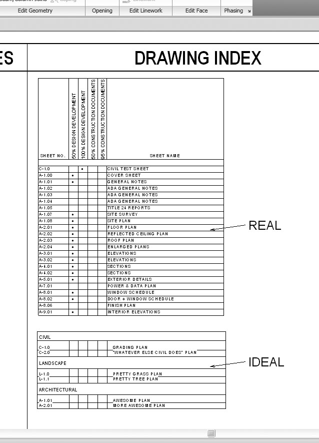

I scoured the forum and am surprised that this question has not come up...  I have organized my SHEETS in the PROJECT BROWSER by DISCIPLINE (which is a Project Parameter I created).  Now, I would like the DRAWING LIST to not only organize by discipline (which is easy with a DRAWING ORDER number parameter), but also show the DISCIPLINE as a HEADER within schedule when it is placed on a sheet.  For example, see screen shot below.  Existing sheeted schedule is above a text note of my desired outcome.

So do that....
Just turn on the header for your groupings and hide the group column.

That looks similar to something I have done. Try putting your discipline param in your schedule so you can use it for a header, then make it a hidden column.

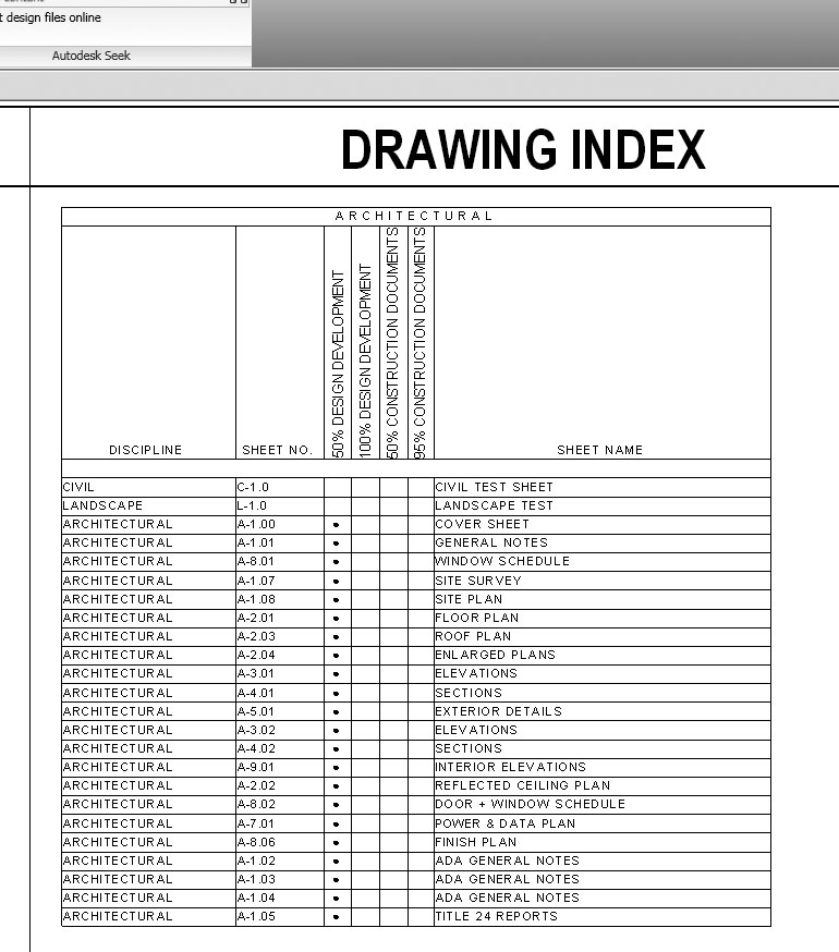

I apologize.  I am not following.  The DISCIPLINE parameter is scheduled and hidden.  How do I make each discipline a sub-heading?  (See attached with the parameter visible)

Check the Sorting/Grouping tab in the schedule properties.

AH-HAH!!  Drawing List Properties > Sorting Grouping > Header check box!
Thank you very much!!
