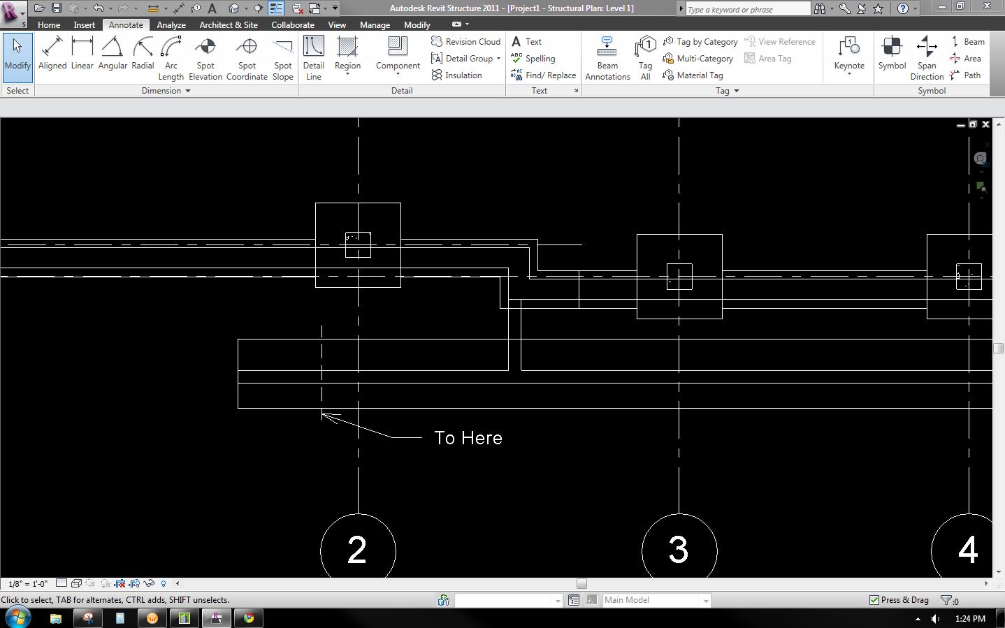

Is it possible to pull a Wall Foundation back from the end of a wall.  I can pull it past the end of the wall, but not the other way.  Please refer to my attached picture for reference.  I would like the wall footing to stop at the dashed line with the note "To Here."
 Thanks in advance.
 I use Autodesk Revit Structure 2011

So the wall has no foundation beyond that point... interesting....skyhook?  I have yet to see a skyhook work.
Split the wall vertically and you should be able to end the foundation.  You can still join the walls so the vertical line goes away.

There is an existing building at that point where the foundation will end.  Most likely we will scab onto the existing footing for the wall support.
I figured splitting the wall was the way to go.  Thanks for your response.
