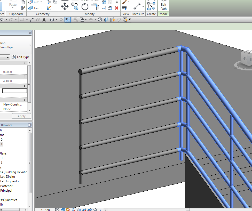

I have a railing on a staircase. Now the staircase meets the floor.
I wish to continue the railing of the staircase towards the floor.
They don't Join Geometry nor one railing accepts two hosts... Can i connect the stair railing and floor railing by anyways?

Stop the Stair railing then create another in that floor....

It is a good work around for one floor. But my staircase goes from Ground floor to second floor.
Thus, when we start climbing from Ground floor and reach first floor, we can add a railing to the first floor slab the way you have shown and connect both railings. But now the same railing of the floor which we added, continues to join with the staircase rising from first to second floor, the slopes do not match..
what to do?

Show us some screen shots to figured out the issue please.
