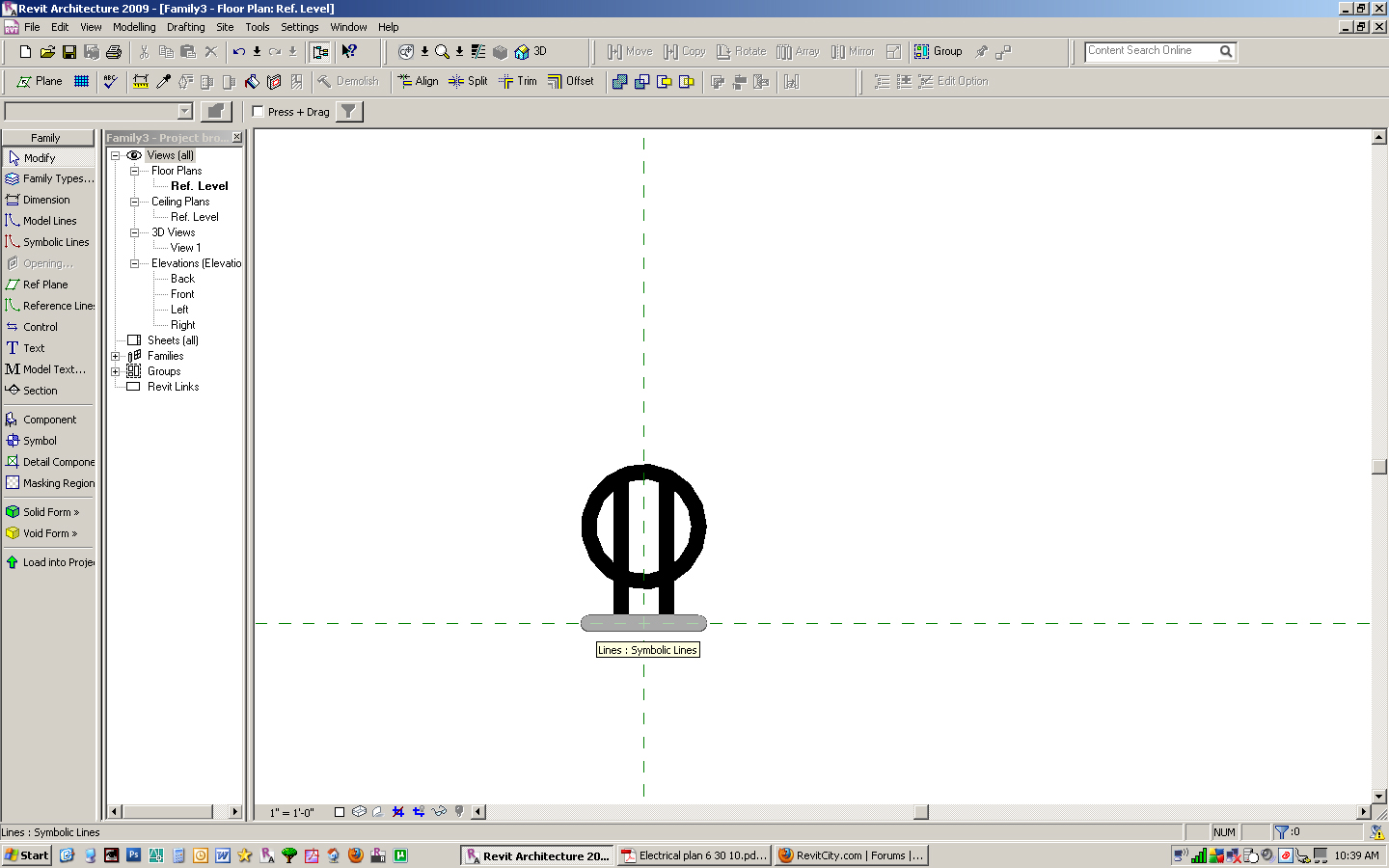

I want to create a 2d symbol I can just plop everywhere i need them on the plan. I used symbol lines so it wont show like model lines everywhere. but The lines are all fat. how do i get them to be thin lines. It seems from the grafix tab that #1 pen is the smallest.
Do I do something with the overrides?
Michael
Wed, Jul 21, 2010 at 1:01:49 PM | 2d electrical symbol line wieghts
Joined: Tue, May 22, 2007
5921 Posts
4 Stars: 205 Votes
just type TL
