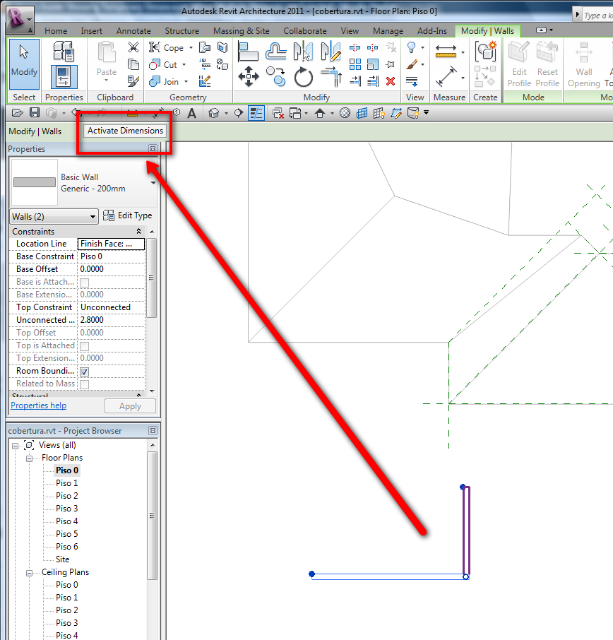

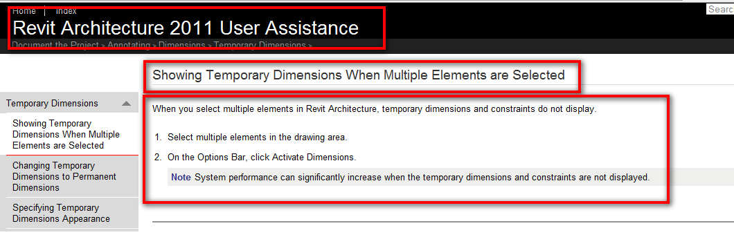

Ok a little of subject here, but where do I find the "activate dimensions" button to show temporary dimensions.  I am confused Sad

From your HELP menu, use it...

HAHAHA.  I had looked that up but the button never appeared.  After selecting another wall - I realized that temporary dimensions are on and that I cannot use the dimensions because the wall was anchored to an exterior wall.
