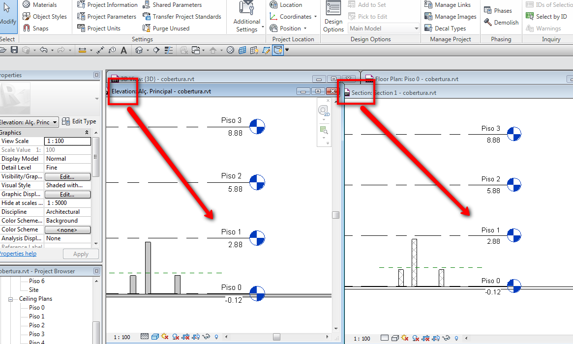

I'm working on a renovation/addition project and when we first started out we didn't have the civil and survey, so we based our elevation marks on the existing drawings.  Lets say that was in the 400'.  Now we are at the end of the project and we noticed that the civil numbers are in the 900's!!!!  How do we change this on our drawings without messing up our sections, elevations, and details?  When I tried to change the numbers manually, it moved all the walls attached to it, 500'!  Help, I'm freaking out here, lol.

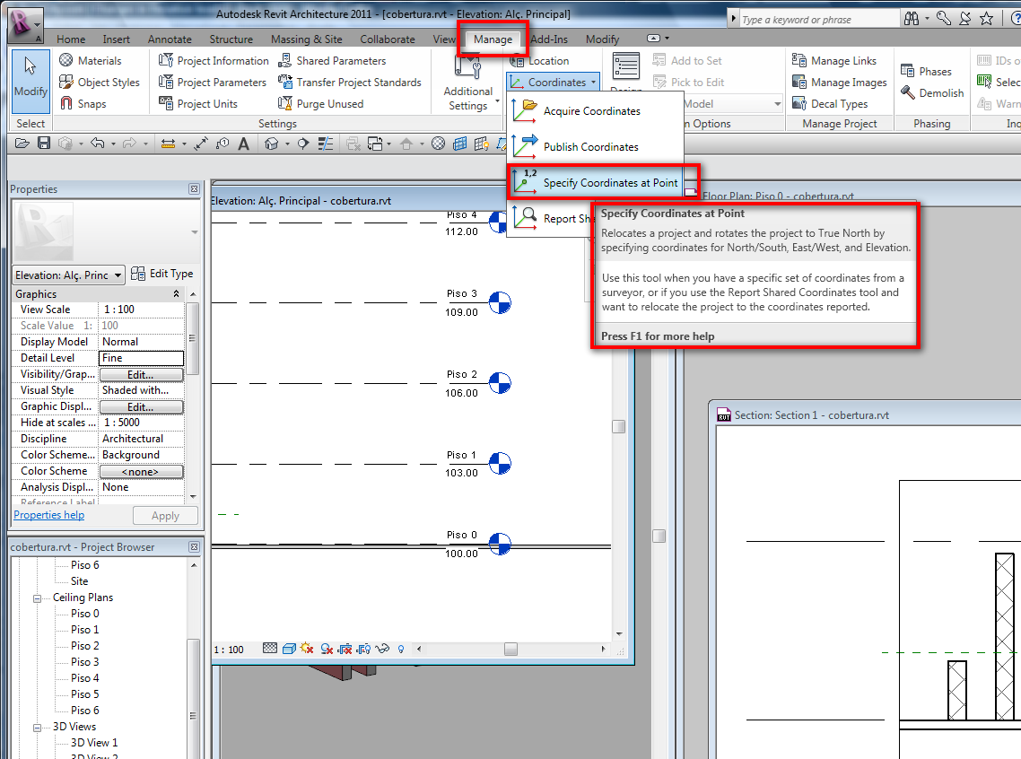

You must use Coordinates > Specify Coordinates at a point

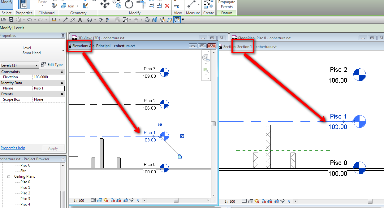

Lol, I did but it's not changing the numbers on the level.  It shows the right number under the properties for Specify/Report Coordinates.  Please, see attached.

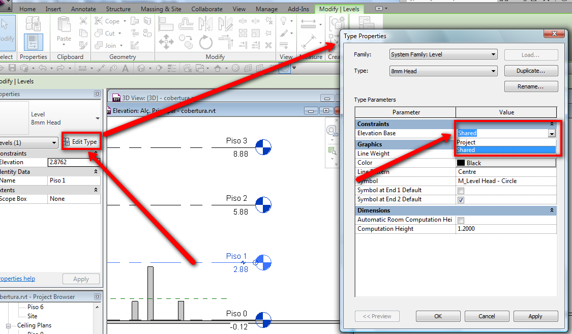

Select the Elevation line, go to properties > edit Type then change the "Elevation Base" project to Shared

Nevermind!!!! I went into the properties of the Levels and changed the elevation base from Project to shared.  Thanks again!
