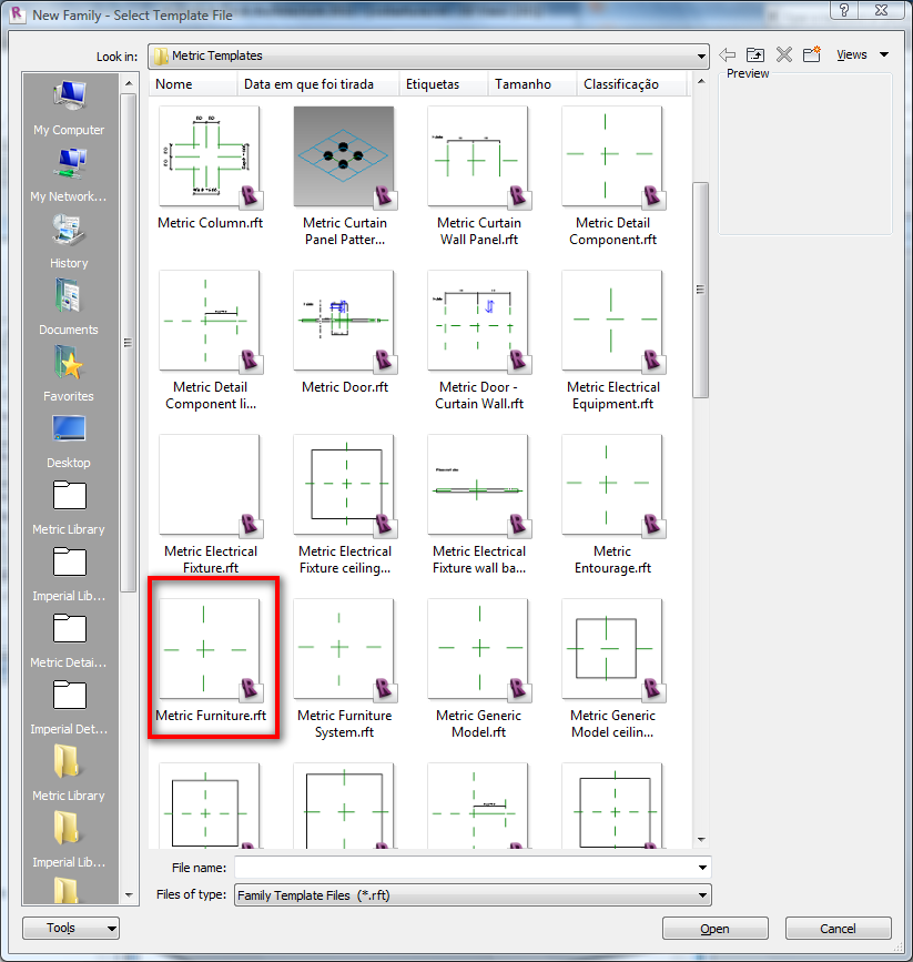

You have "Templates" (families) to create what you want in Revit
Go to Create > New > Family then choose "Metric/Imperial Furniture" to create that table...
