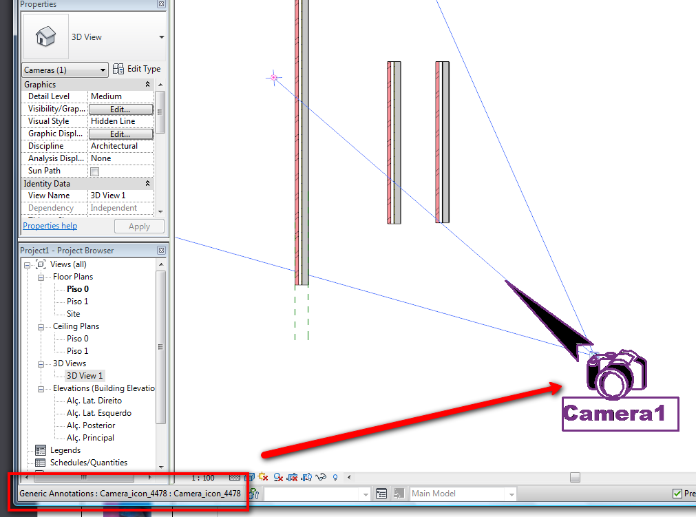

I am wondering if there is a way to place a tag on a floor plan that references a camera view. I know I can just place a tag there but I would like something that would update if the tag is moved on the sheet. I was thinking of using a section and tag and selecting reference other view but the camera views are not listed there.

Humm nothing like that, use a generic tag where you can adjust the angle of the Camera "Tag"

A work around could be an elevation marker. Then place the elevation on your sheet - turn off everything in the view and place your 3D view on the sheet above the view title.
Another poster on AUGI posted this: http://www.screencast.com/t/8OF5jGdeYxj
