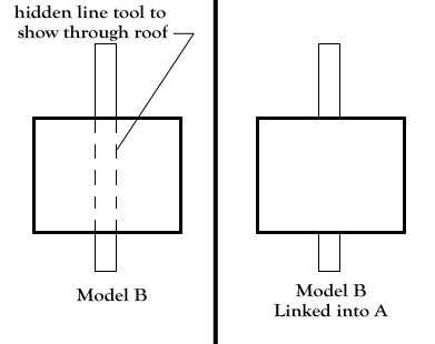

We have a project (A) that has a linked in model (B).  The Model B has some objects that we have used the hidden line tool on to show through roofs but when we link B into A the objects lose the hidden lines.  we have tried several different ways of doing it but have not been able to get the hidden lines to show up through the link.  the same view is being used in the link as we did in the original model with regards to VV graphics.  Any suggestions?

The hidden line tool is view specific so that will not work unless you link by view.  If you can not link by view, then I would just add detail lines.
