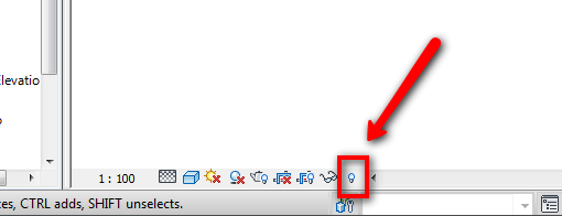

Go to a 3D view and check if you can see that scope box, then drag the top blue arrows until you can see the S.B. in your plan view

Did you check if you have that Scope box hidden? check in "Reveal hidden Elements", also in 3D view select the S.B. and go to properties > Edit, select the view you want then turn "Visible"

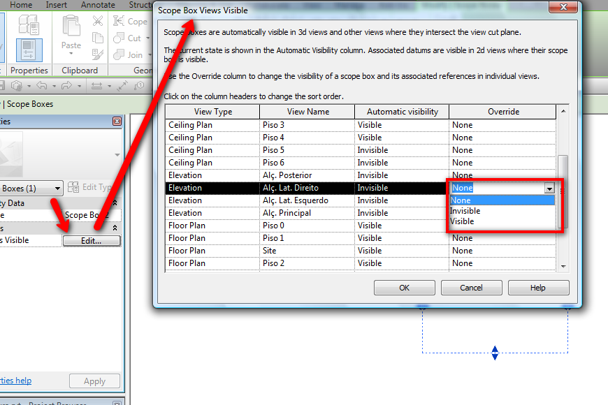

Thu, Oct 19, 2017 at 12:33:04 PM | Scope box not visible
#9
sasa627
Joined: Sat, Nov 14, 2015
0 Posts
I had the same issue of Scope Box disappearing... It is visible in 3D and I double chekced it is set to visible in under "Views Visible" in the view name I want. My last solution was to override and set ti "visible".
