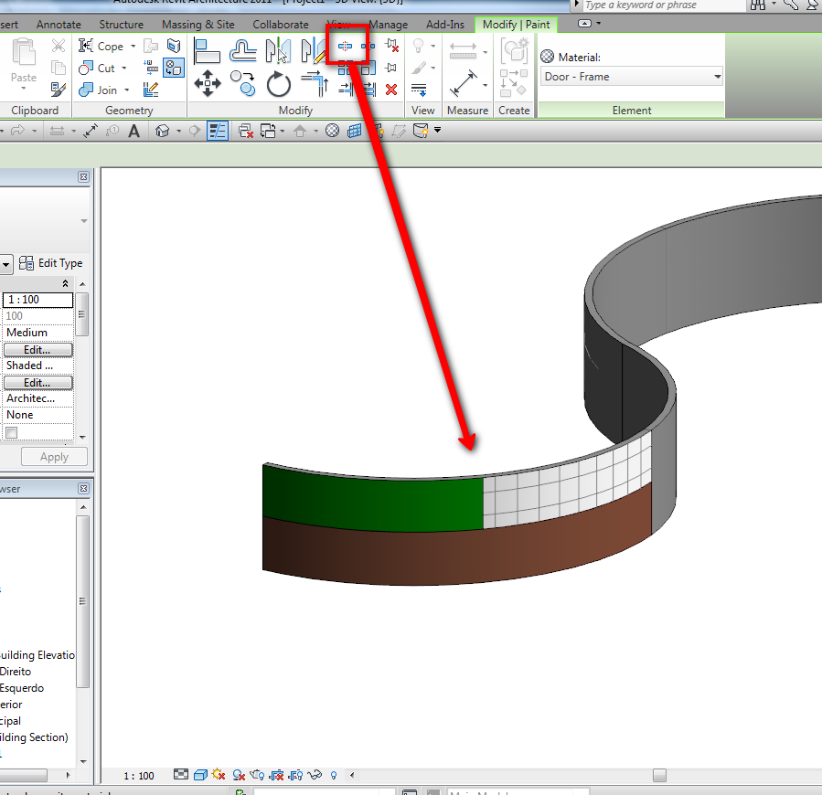

2011 make it easier to work with curves (curved beams, axias etc) I like to 'paint' my wall for the various finishes.  I now have designed a house with lots of curved walls (in plan).  I have not been able to Split faces to apply different material.  I can paint the whole wall.  Is there a way in 2011 to do this?

You can't BUT you can use the "Split Element" tool

Thanks for that advice.  It does however create a lot of other issues. For simple geometry, this can be an option.  Thanks again
