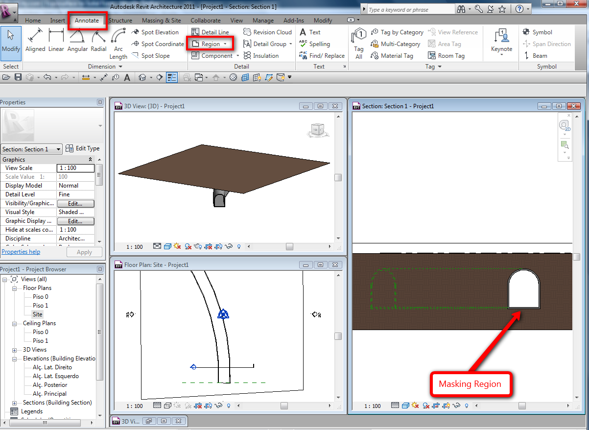

I am trying to create a quite complicated underground building, with tunnels and rooms. You cannot cut voids into a toposurface. Building pads and split surfaces would not work. I have tried two toposurfaces on top of another, but it does not create the effect I am looking for.
I have the idea to create a solid conceptual mass using my site, and then cut the void forms out of this. I am able to import a 3D mesh of my site into the conceptual mass editor, but cannot seem to be able to create a solid out of this, ie solid below the surface of the ground.

"You cannot cut voids into a toposurface" - That's right
 "I have the idea to create a solid conceptual mass" - use the In-Place to create your Tunnels then use the "Masking Region" tool to "Clean" the hole....
"I am able to import a 3D mesh of my site into the conceptual mass editor, but cannot seem to be able to create a solid out of this" - Because it's a Mesh, you must convert that Mesh to a solid in CAD before you import to Revit, use the LISP routine "M2s.lsp"
