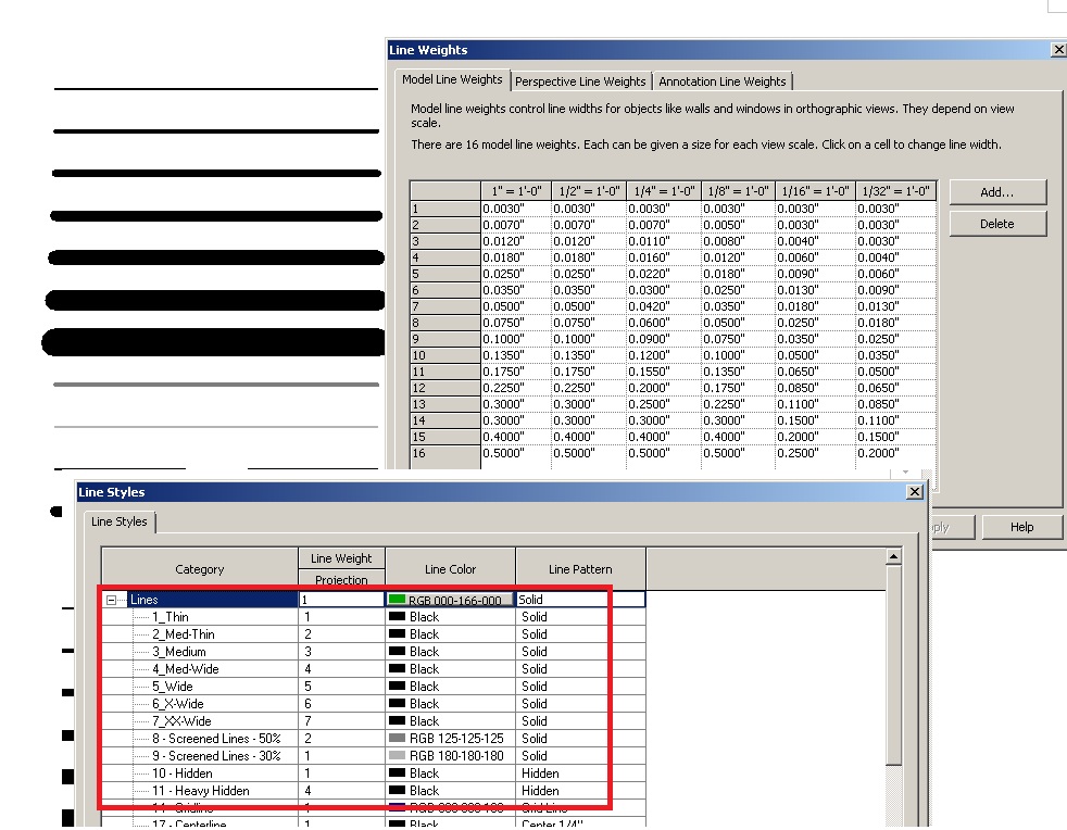

Dose anyone have the following that they would be willing to share:
1.  Object line wieghts that look good when printed off Revit converted PDF drawings (not that this should really make a difference)?
2.  A stanadardized sheet numbering system (tried the AIA link and it is no longer available (at least the one recommnded here in RevitCity) and I cannot afford $400 for National CAD Standards (NCS))?

Hey there -- I can't really enlighten you on sheet naming/numbering convention, but I can show you our utilitarian line weight and type conventions!
Screenshot shows the basics.
