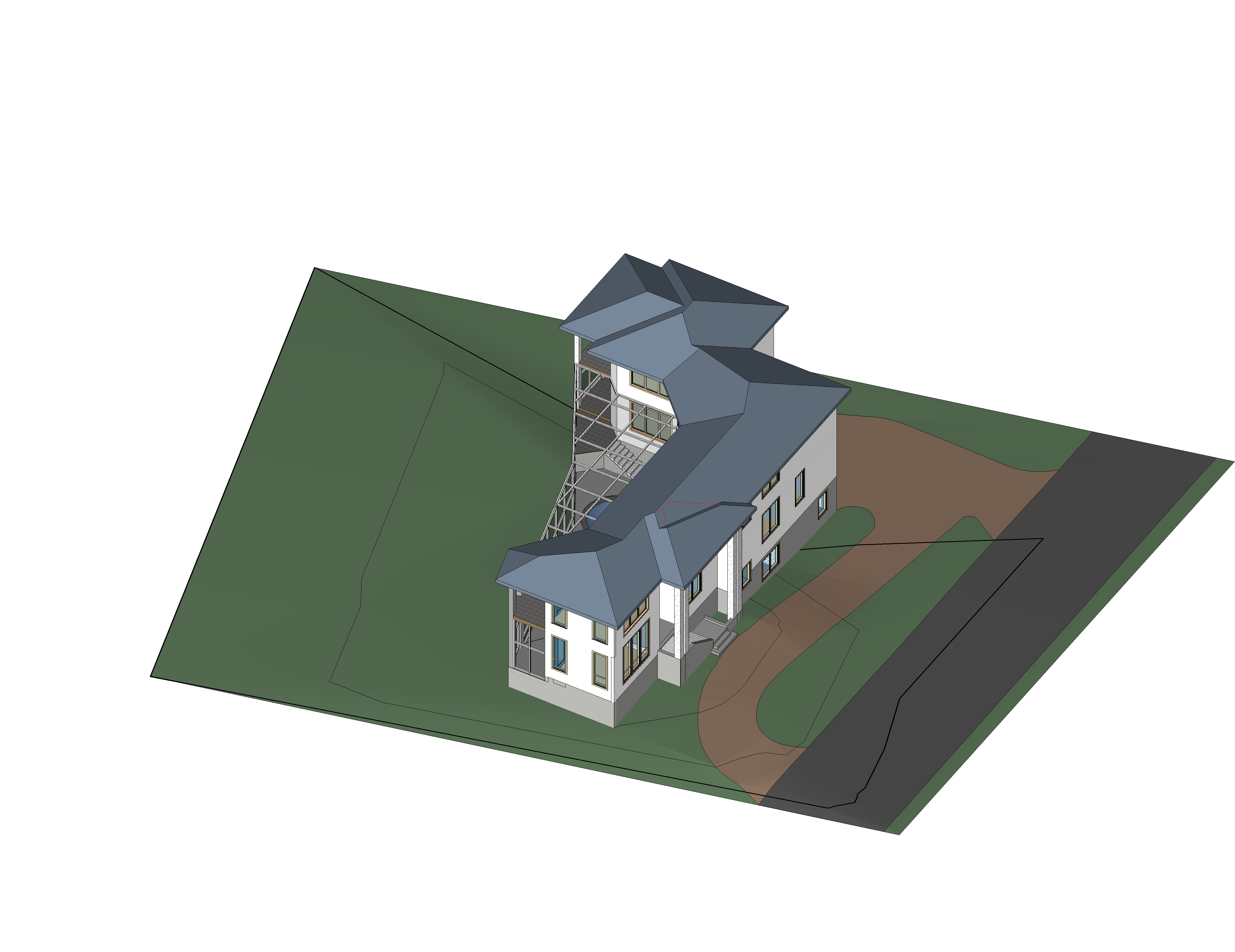

 Hi.
 The attached image says it all I think. The roof that's there is what Revit does and the red lines show what I actually want. I'm in RAC 2011.
All the slopes, eave heights and overhangs are constant all the way around.
Any help with this would be greatly appreciated.
JF

And of course the image didn't attach. Lets try that again.

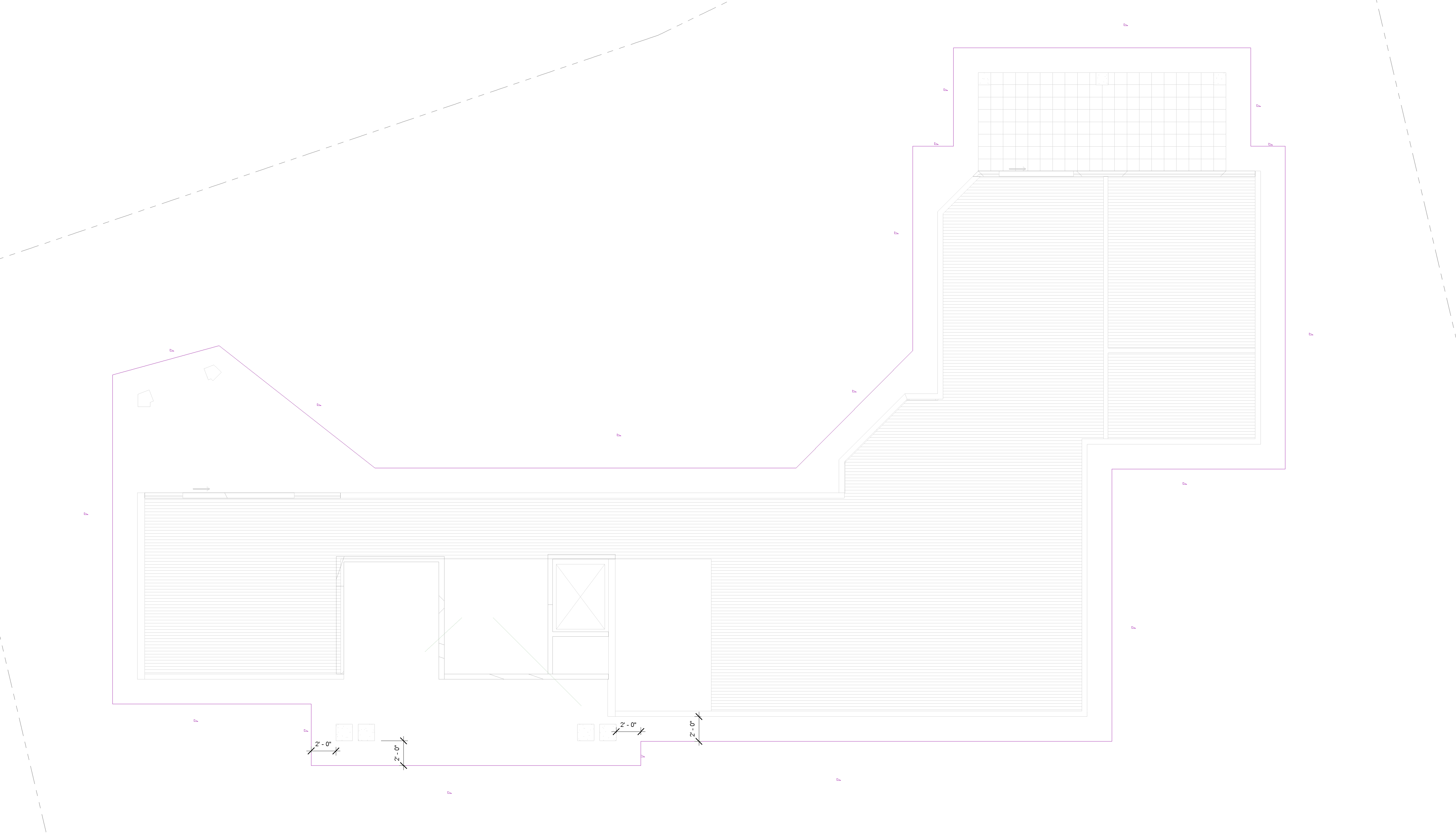

 Ok. As requested here's a shot of the roof sketch. All overhangs are 2'-0", all slopes are 5/12. The walls are stacked walls so all the lines were drawn using "pick lines" instead of the walls. This is also the case at the column locations out front. All eaves are subsequently aligned using the "align eaves by height" option.

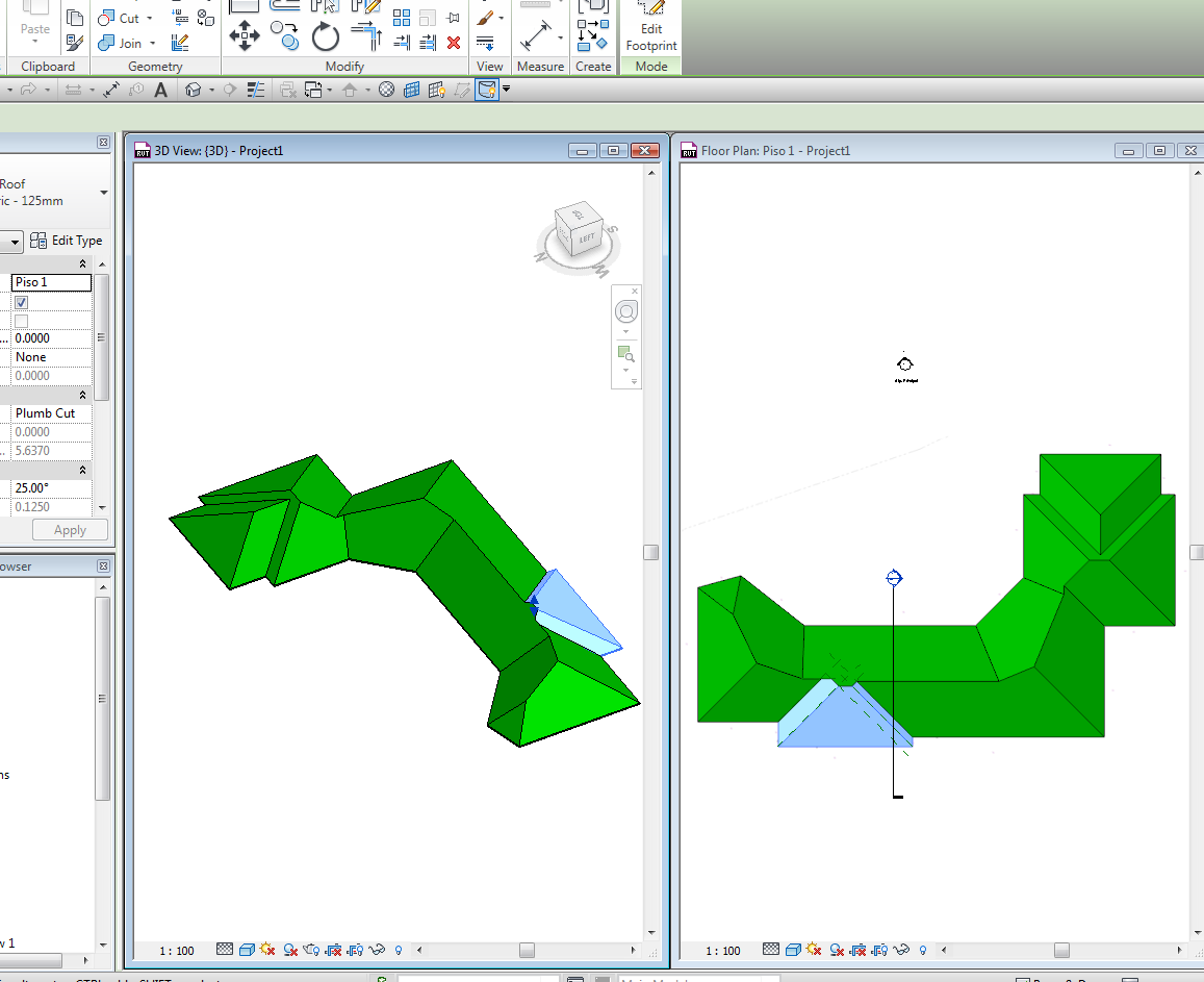

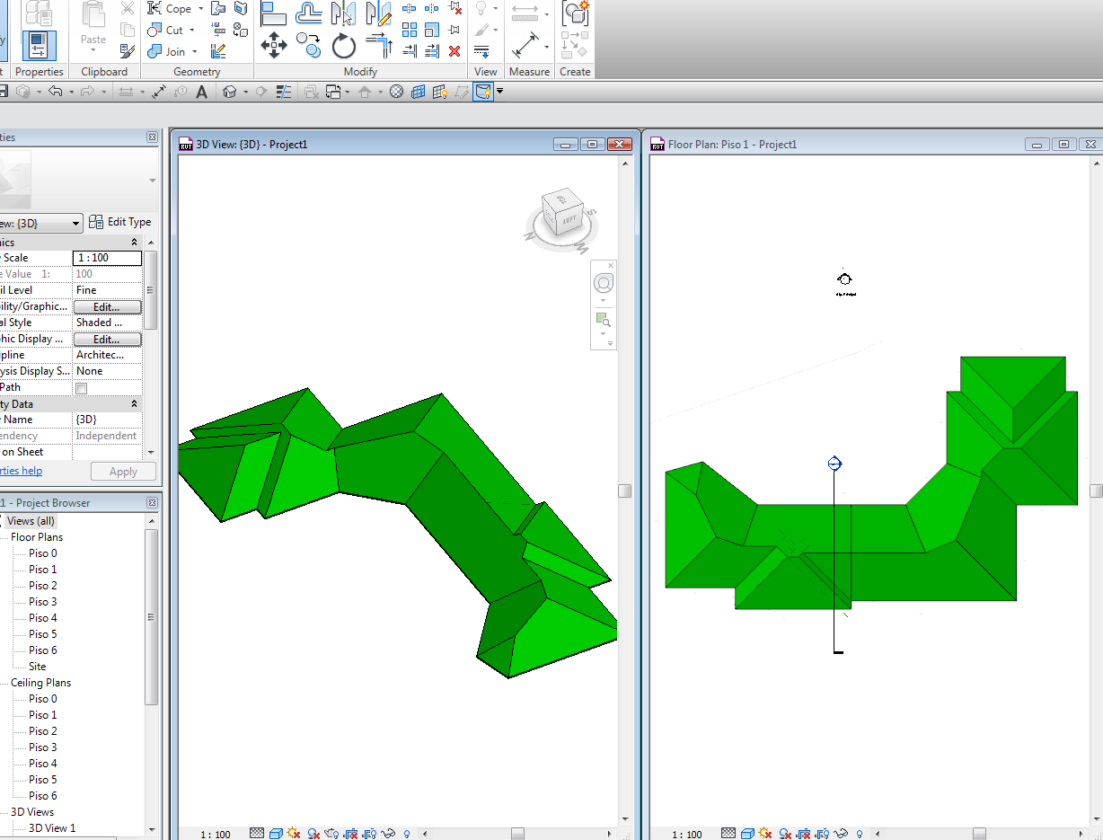

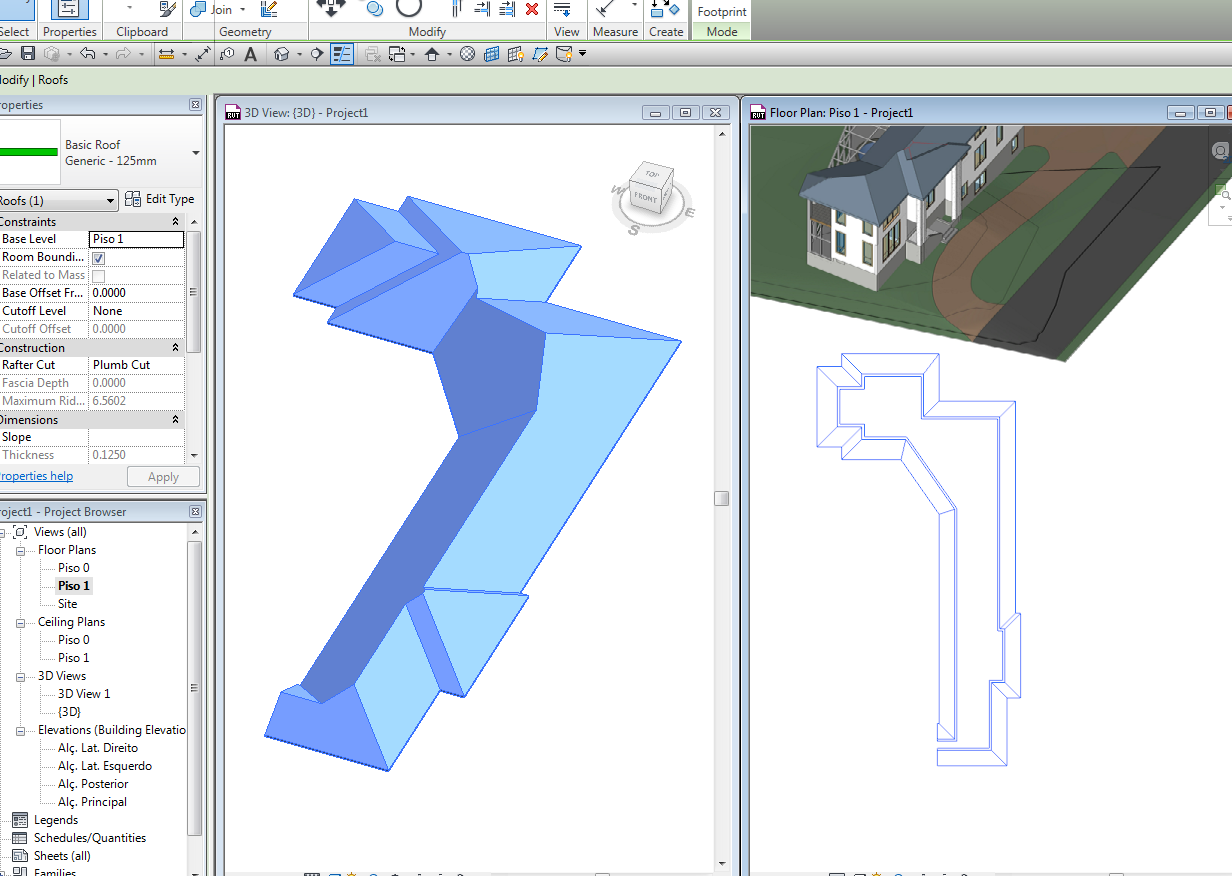

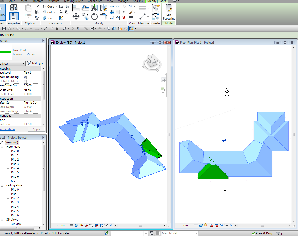

You can't create that in one piece, you must create that in two different roofs like you can see in my images attached....

 Ok. Got it.  Thanks.
