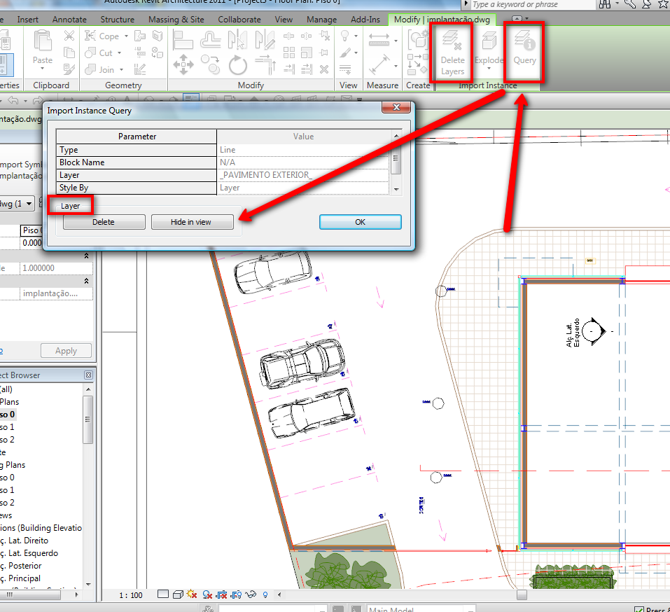

Each time I import a CAD file.  I am unable to manipulate the layers in Revit. It imported all of my ACAD layers stacked on top of one another and I was unable to turn off the one that I did not want to see.  I did an origin to origin, all layer import.  Because of this I seperated my ACAD file into layers by freezing views that I did not want to see.  Now Revit is not allowing me to do a CAD import in certain views.  Have anyone had this problem?

Select the Cad file, in options bar you have a "Query" button then select the Object (layer) you want to hide or delete...
