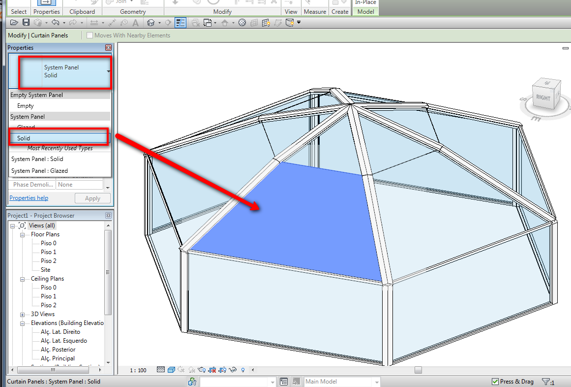

can you some how substitute or redefine the sloped glazing properties to be a transulcent panel like a Kalwall panel?

Select the glass and change that to Solid then change to the material you want in properties of that solid panel

never mind, got it
