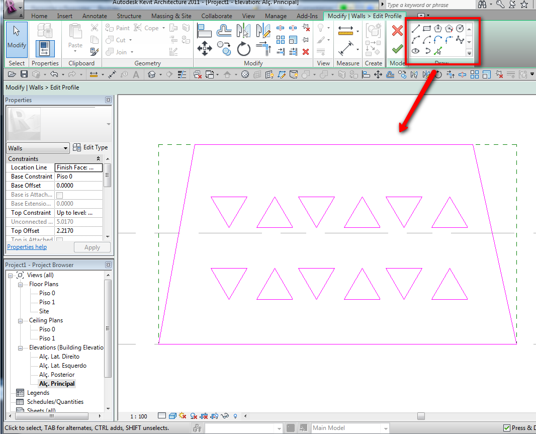

Hi I am really new to Revit, (just learned over the weekend).  I am trying to work on a project in which I have designed a feature wall in the space that will have geometric (mostly triangular-shaped) cutouts that will be see through.  How on earth do I accomplish this in Revit...  Please help!!!  On a time constraint to get this done.  If anyone is willing to give step-by-step instructions, I would really appreciate that.

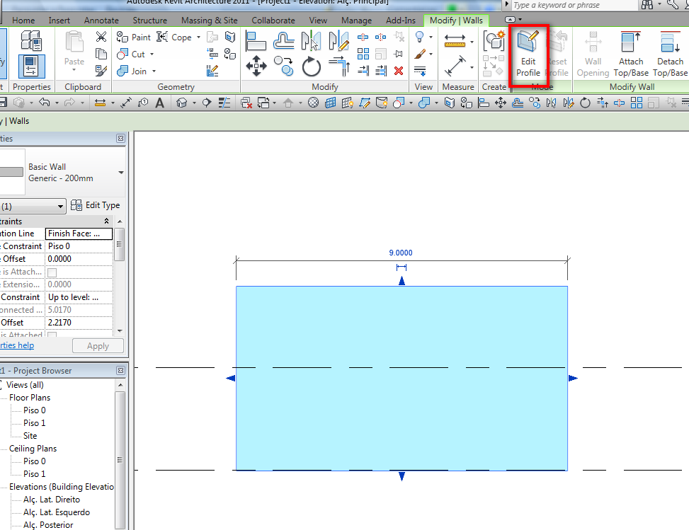

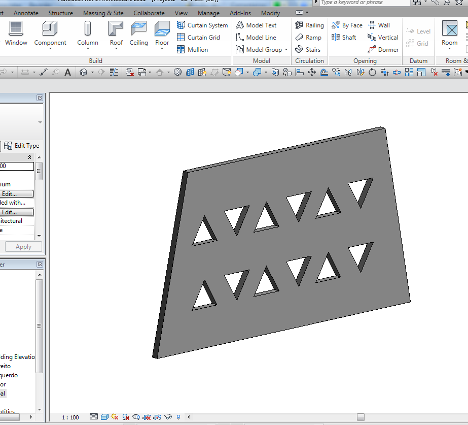

Edit the wall then you can change the shape like you can see in the images attached...

Typhoon,
 Thank you.....one question.  What view are you in to see the wall straight on?  Is that when you initially select to make a wall or is it (the first one) in elevation view?

You can use a Elevation View or you can create a section view near to your wall...
