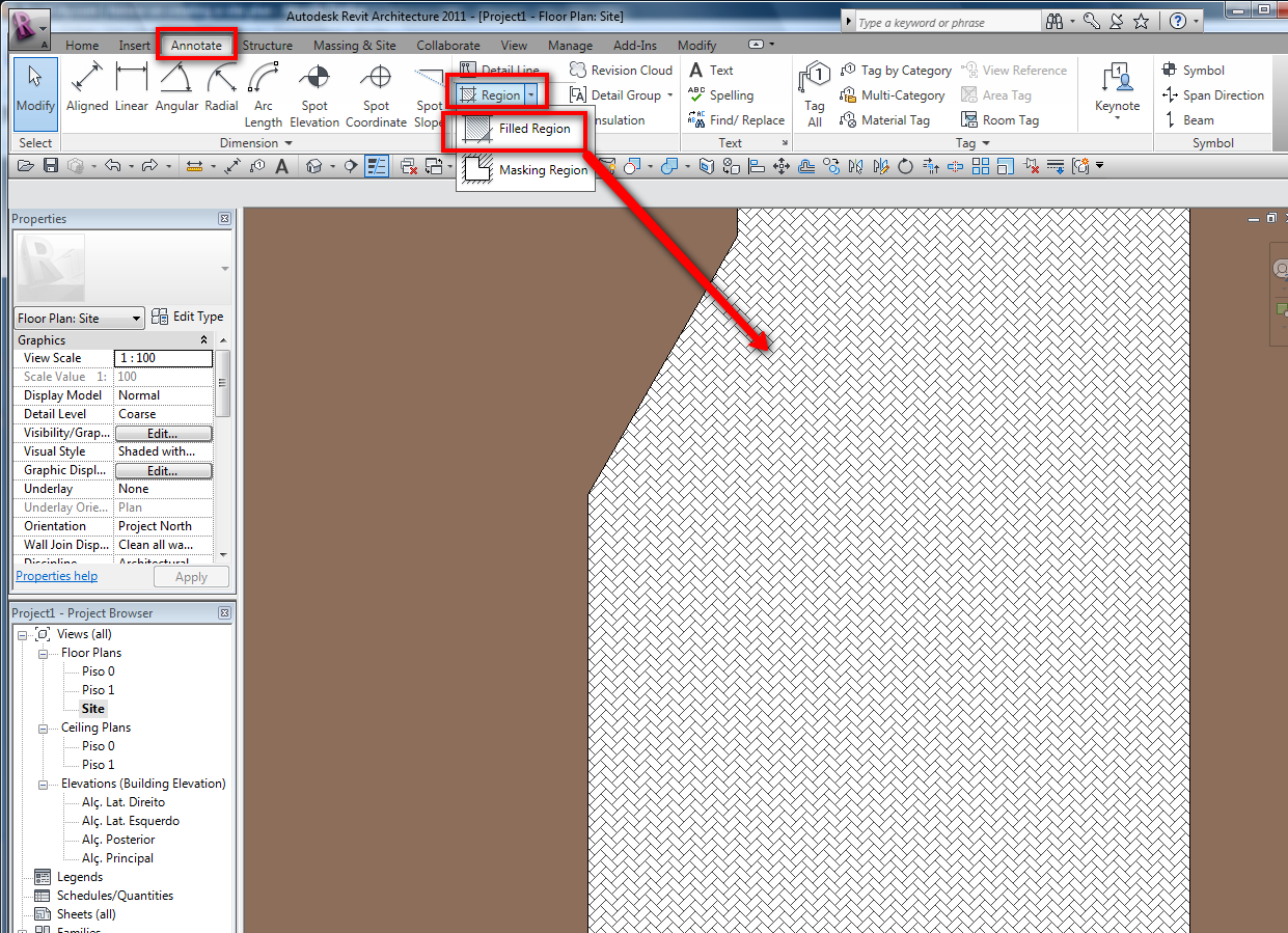

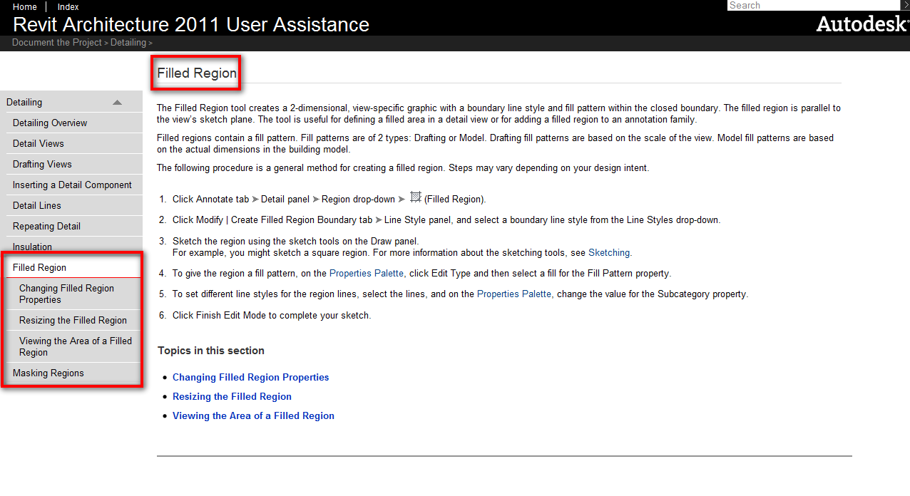

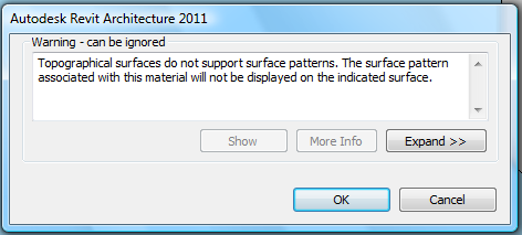

"And then put lots of nice hatches over them to create a good looking coloured site plan."
You can't apply surface pattern to your site BUT you have the "Filled Region" to solve your problem, check your HELP menu to see how to use it....

You can go some way using floors, ramps and / or pads. These take surface patterns.
Subregions will split the topo and that can be used to snap to for filled regions.
