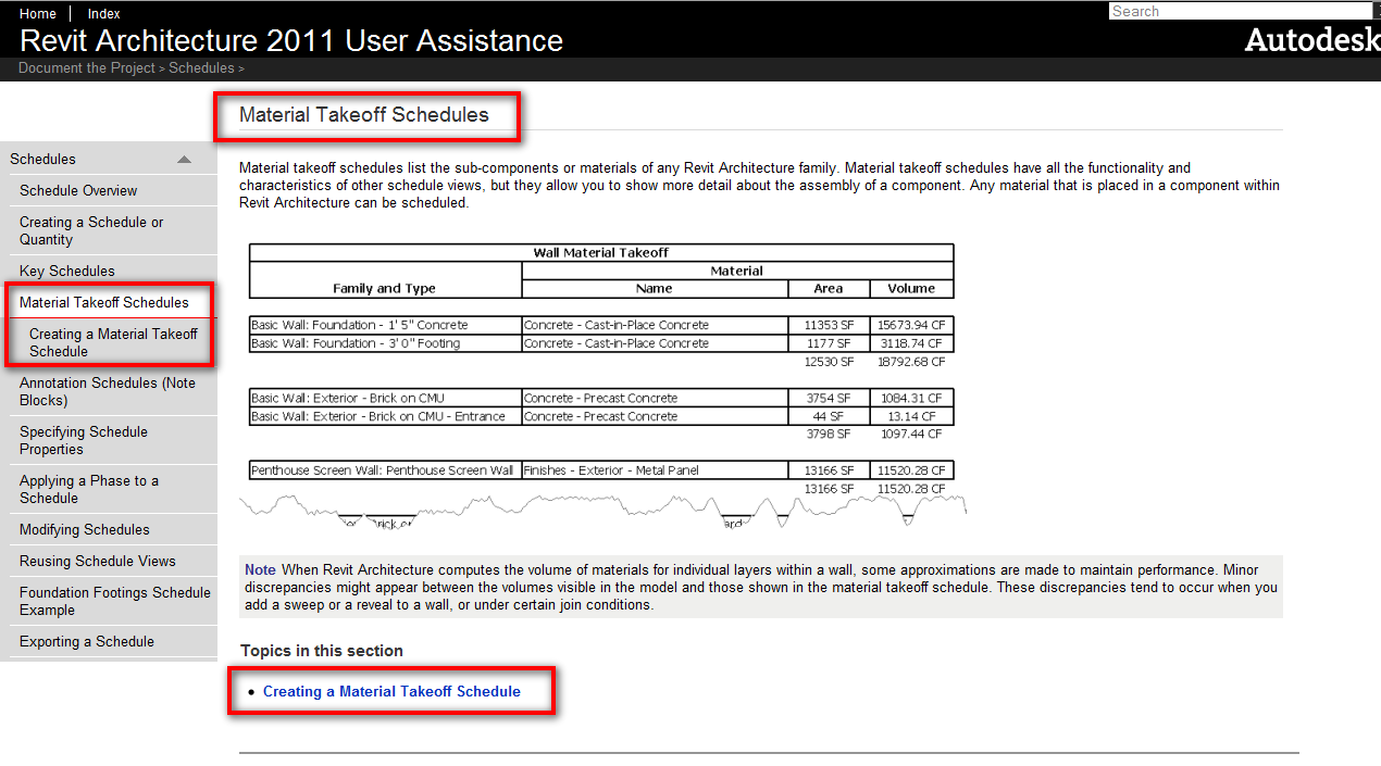

Hi
i just noticed that revit started using this material takeoffs thing.  I've never used it before and I seem to know how to use it.
Other than the stud count section.  How do I make a schedule that counts the studs in the wall.
JD

Hi
So i've read that
and it still hasn't given me any clue on how to do the stud count.
i know how to do the other material takeoffs like concrete.
but using the stud count in the schedule option nothing shows up there.
my question was just some sort of hint that you guys can give me to get this number to actually show up.
i don't ask the questions that i need help with on here if i haven't read the help menu.
i ask them cuz ive read it and still hasn't explained to me or i just don't get it.
JD
Mon, Jul 12, 2010 at 11:16:47 AM | Stud count for Material Takeoffs
Did you model any studs?  If you didn't (and I think you didn't), then Revit can't count any.  We don't model studs in a wall or concrete blocks in a block wall.  Quantities of items like this are takedn off by area or lenngth of wall.
