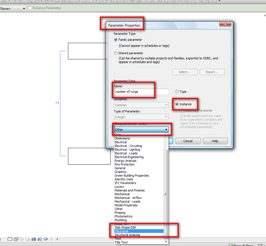

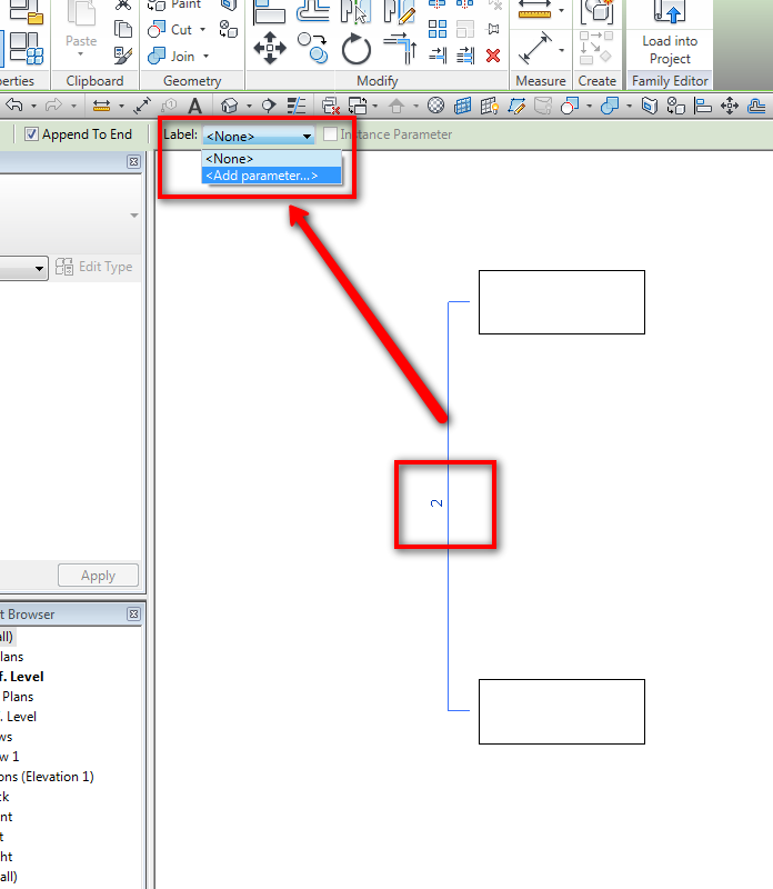

That "number of rungs" is the parameter from the "Array, after you create the array, select one element then select the line with the number (2), in the options bar select "Label / Add parameter", then give it a name (number of rungs), and a group parameter like you can see in the images.

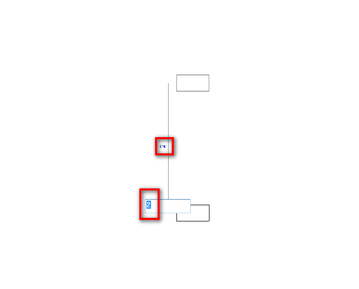

SELECTION PROBLEM
click one item in array and right click number of array and you will not get the edit label option
drag and  click all items in array and it works

No need that, you must SELECT the LINE of the array and not the number, watch this: http://screencast.com/t/NzFkYTlm
