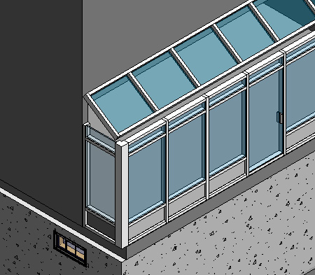

In my project I have a small solarium attached to a house. I drew the solarium walls as a curtain wall and the roof as slope glaze. I added the mullions to both the roof and the walls but now I have trouble connecting the slope glaze roof to the walls. Any clues of how to solve this problem?  I attached an image showing unconnected roof and walls
 Thanks in advance

Select the curtain wall and in the options bar you have a button "Attach" then pick on that sloped glazing OR if that don't work edit the curtain wall panel and change the shape like you want.
Edited on: Fri, Jul 2, 2010 at 5:23:30 AM

It worked, thank you
