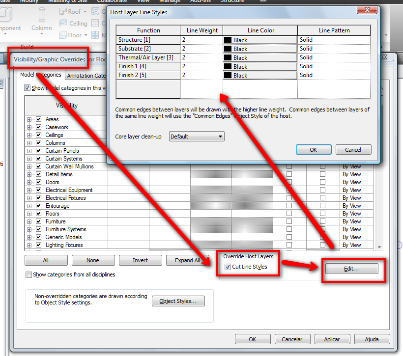

By default in Revit the linetypes of walls are set to black. I want to change this. I would like to give different colors to the different layers of a structure.
For example inside the structure of a wall:
-  structure [1] : blue and thick
- substrate [2] :black and thin
- thermal/air layer [3] :  invisible
- Finish [4] : green and medium thick
- Finish [5] : red and small
How can I change these things? I looked in the object styles, but couldn't find it...
Can anybody help me out?
Kind regards,
Matthijs
Thu, Jul 1, 2010 at 4:12:41 AM | Change linetypes of a wall
Joined: Tue, May 22, 2007
5921 Posts
4 Stars: 205 Votes
Simple, type VG (Visibility / Graphic) then "Cut line Styles" like you can see by my image
