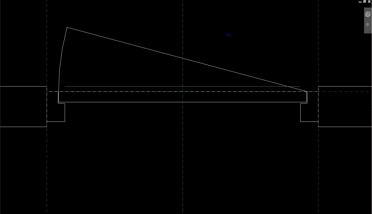

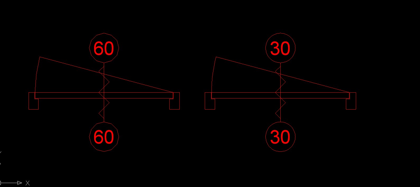

Hi,
I am still not so familiar about the family.I would like to add fire resistant symbol in the door family(like the dynamic block in the CAD)The effect I would like to achieve is when I insert the door family in the project, there will be a default value(30 or 60) and I can still change the value when I want.
Is there anyone can help to tell me how to make these kind of symbol in Revit?
Thanks

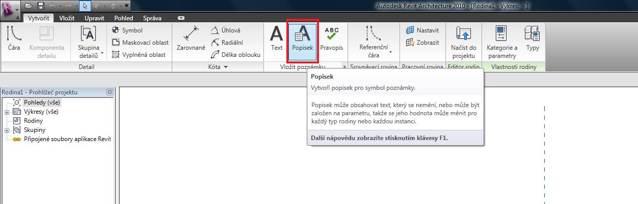

You have to create new family with this symbol and add the family into the doors family.
This new family must be done as families for notes (description) or whatever the right term for it is. There you dont see only:
"A"  to add text but ".A"  (in place of dot, there is small paper). This option is only in specific family for notes.
Text "A" is simple text and ".A" is parametric and is used for this.
When you open the "New family" you are in "Metric Templates" there you have 3 folders. 1 of them is folder with templates to Notes. Here you have templates with option to add Parametric text.
Here you can see the Icon:
