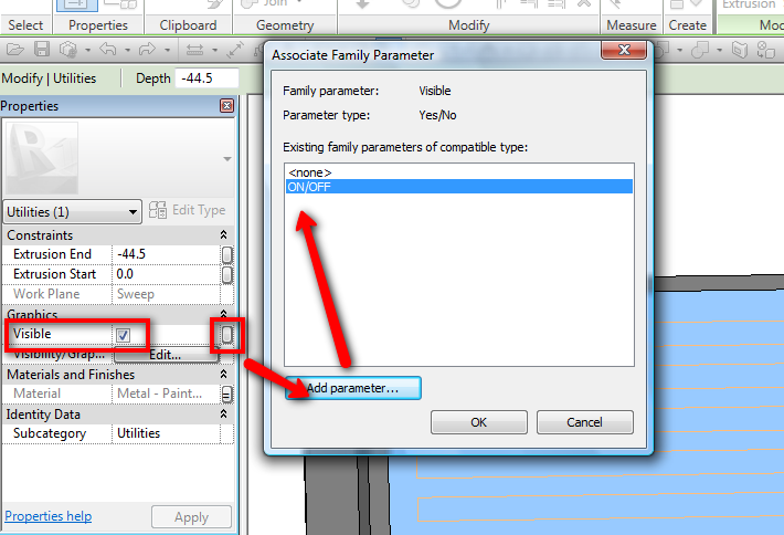

i made a window family fit my demands but i want to add a solid part which can be selectable on-off.
i drawed that part but could'nt make it parametric.Can anyone describe it to me?.
i made a parameter named on-off and selected instance parameter type and on/off type it seems in paramaters but coulndt apply it to solid.when i select solid i cant find any option for to match it to that parameter.lenght parameters are easy to apply but this is not.
Sat, Jun 26, 2010 at 7:04:27 AM | how to use on/off parameter
Joined: Tue, May 22, 2007
5921 Posts
4 Stars: 205 Votes
In properties > Visible, click on that little button then add a parameter (on/Off).
I think this is what you want...
