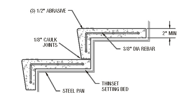

Is it possible to create the attached stair profile?  The closest I can get is having the entire riser slanting instead of just one side.  I can not use monolithic stairs because we are offsetting the stringer and I believe monolithic stairs are incapable of doing that.
I am using Revit Architecture 2010.
Thank you!

I suggest downloading the most definitive guide on stairs from Phil Read.
http://dl.dropbox.com/u/125962/AB114-1.pdf
Phil worked for Revit before purchased by Autodesk and continued to work for Autodesk for a number of years.  He is also co-author of the new Mastering Revit book.
His blog: http://www.architecture-tech.com/
Hint: probably best done with a nosing profile that is the complete tread.  I believe Phil has an example.

what do you mean by "having the entire riser slanting instead of just one side"? isn't the entire riser slanting in the image you posted.

I apologize if I wasn't clear.  In section I would like the exterior of the riser to slant, but the interior to be vertical.  I believe the pdf that Tom posted answered my question.  I will try making a custom nosing that will act as the riser as well.
