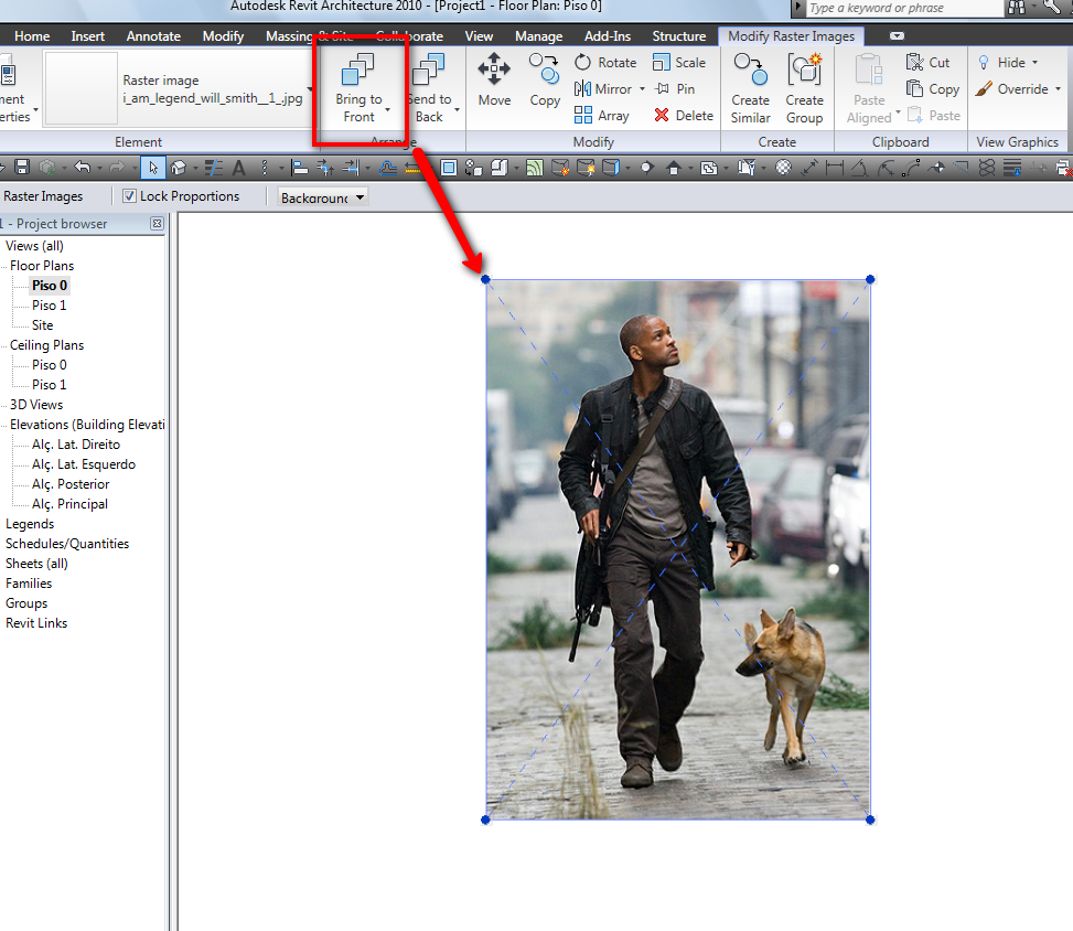

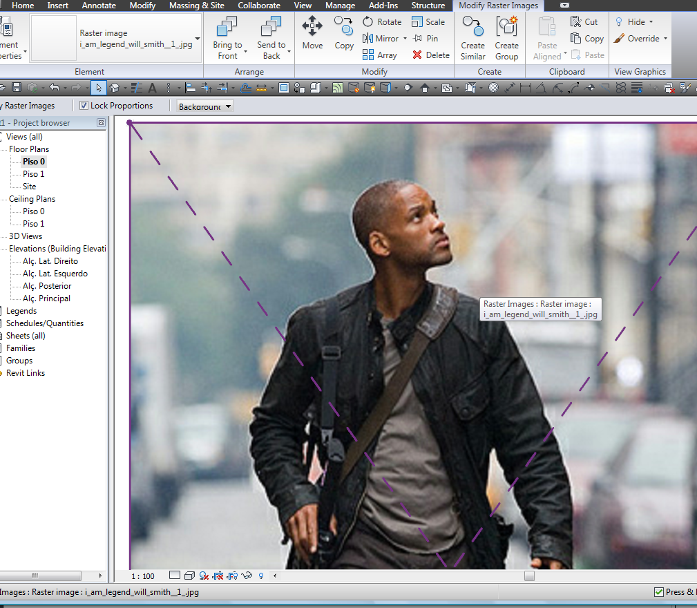

I don't have any problem with that, try to select "Bring to front" and check....

This happened to me once, the problem was big resolution of image. Isnt it too big ?
