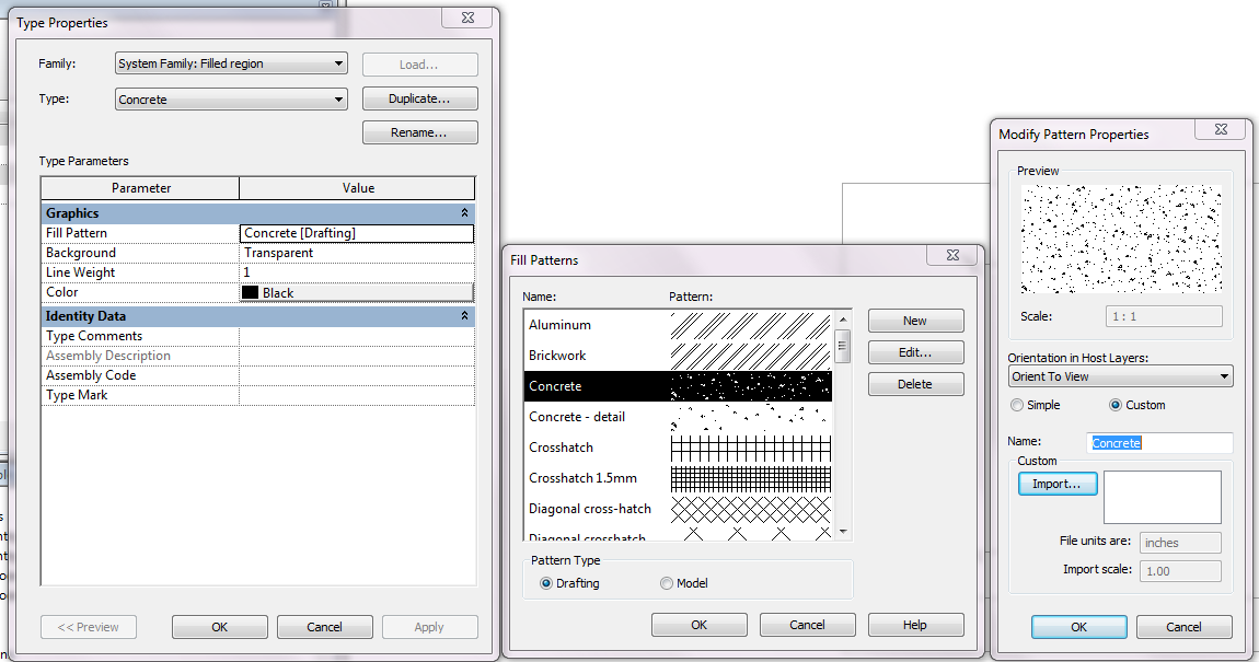

I have downloade a .pat file and saved on desktop.
i now want to import into my Families library. Can someone help on this one please.

Sure!
I assume yu are on Revit 2010/11
Go to your Annotate tab and select a Field Region --> Edit Type...--> Duplicate
Under the Graphics click on the fill pattern (you will need to click on the far right of the pattern name to bring up the Fill Pattern window)
Click New to bring up the new pattern window, in there select Custom and then Import, browse to your Pat file.
Tip: 1. you might need to edit the import scale to get the correct scale for your pattern.
2. make sure you select either Drafting or Model pattern and that your .Pat file is the right category.
HTH, let us know if you get stuck
