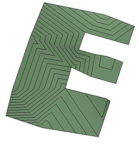

I want to create a site in the shape of a capital E, but revit will ony make rectangle shape site.
How do i force it back to the right shape ?
Wed, Jun 23, 2010 at 7:10:47 AM | creating a site the shape of a capital E
Do you want it to look like the attached?
Just finish your site.  Then split the surface and delete the areas that form the void spaces in the E.
We often extend the site well beyond the property lines (like the real world) then split off the area beyond the property lines and apply a different surface material.  I think this is a better solution.
